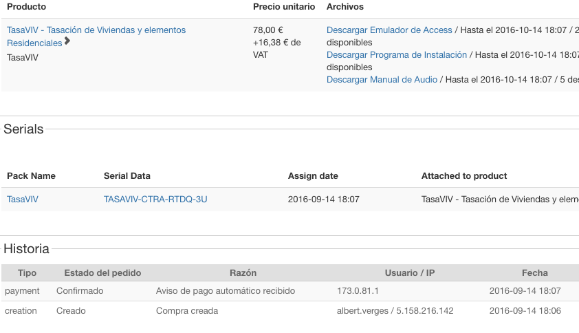

When a user purchases a product on the web you receive the mail, but the serial does not appear (before if I did). However in the backend when I check your purchase if you have assigned a serial purchase.
Not from that moment I stopped working (that update joomla or hika).

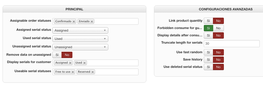

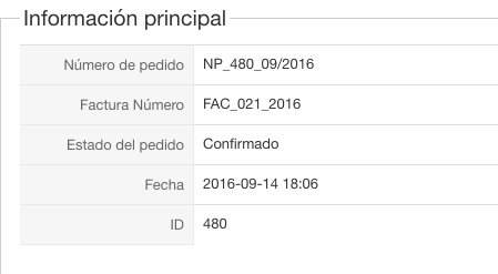

Please provide a screenshot of your order details in the backend and a screenshot of your HikaSerial configuration.
You have to check :
* How the order is confirmed and how the email is sent
* The order status
* The serial assigned to the order
* The serials' statuses
* The HikaSerial configuration for the serial assignation depending the order status
* The HikaSerial configuration for the display of the serial depending their status

9 years 11 months ago #249945
The screenshot show that the order have a serial ; so I'm afraid that it do not illustrate your issue.
Some points from my previous message are still unknown.
