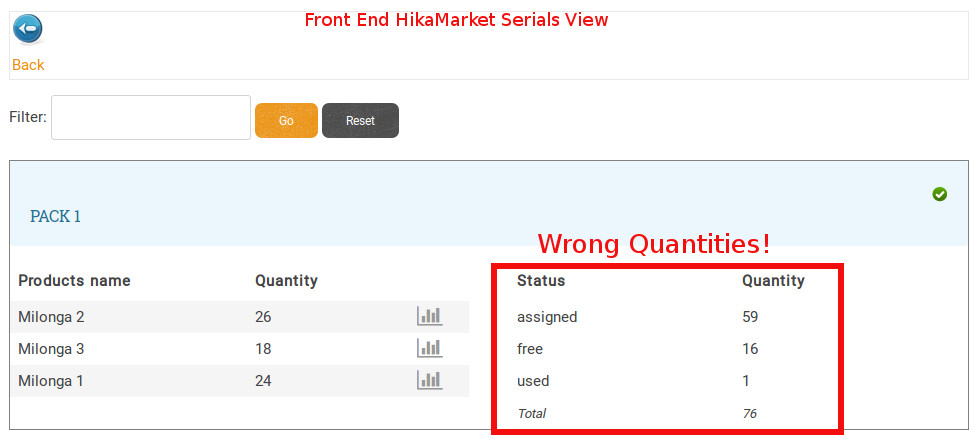

There seems to be a problem with the counter on the serialsmarket Packs.php view. The number of serials that appear in this counters gets out of sync with the database.
Please see the wrong counters in the attached image

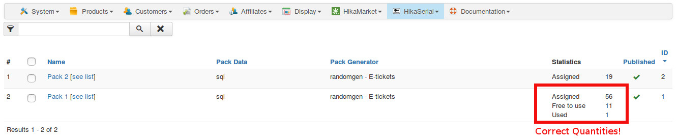

The right serial numbers can be seen in the back-end, please see the attached image
The backend numbers match the database numbers, pleasd attached table
I have noticed the following, the numbers in the front end are initially correct, however when I move an order in the backend into CANCELED or REFUNDED status, then the numbers in the front end start going wrong since they keep incrementing the number of serials when readjusting the status of the serials.
This ONLY happens when the order that I move in the backend into CANCELLED or REFUNDED was paid via MangoPay payment method. If the order had been paid with Bank Transfer or Stripe the the counters in the front end seem to readjust correctly
