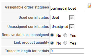

I've managed to get it to assign a random serial from the 'pack' so far, but the serial only shows up after I go into the order and hit "Refresh Associations". I have "Assignable Order Statuses" set to confirmed, shipped in the HikaSerial configuration.
Am I missing something in the HikaShop configuration so that the serial generation code gets called when the payment is confirmed? or could this be related to me still using the PayPal sandbox environment?
