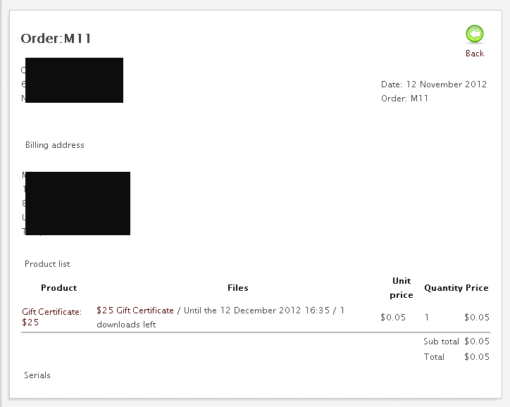

I have the gift certificate made as a product with characteristics $25, $50, $75, or $100. I made the gift certificate as a pdf the buyer will download (one for $25, one for $50, etc.). To the gc product, I assigned nothing. To the characteristics I assigned each their pdf file and hikaserial named "gift certificate" which uses coupongen pack generator.
When I go through a sale on a gift certificate, I do not get the serial number assigning nor do I receive the download address for the file pdf in the email.
What am I doing wrong?

Now I did get the confirmation email link and when I click it, it says "INVALID_FILE_NUMBER" .
There is no indication of a serial number in the email. When I view the order in my browser I can only see underneath in text the word "serials"
