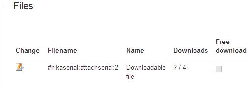

12 years 8 months ago #131312
Any ideas?

I fixed your product configuration.
You hadn't set the "filename" but put it as the "name", which is not understandable for HikaSerial as you can imagine.
Now you have a "file not found" problem because the "attach serial" configuration is not configured right. The file can't be find and I can't know what are the files you want to use.
Please use the common way : "/images/my_image_name.png" (or jpg). And please check that the file is right in the folder and with the right file name. For the moment, your two configuration point to files which does not exist.
