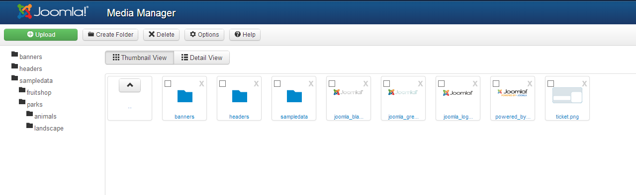

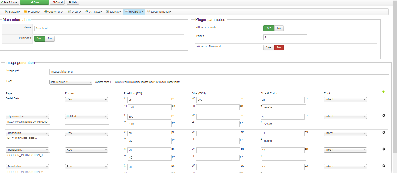

  • Posts: 4
12 years 11 months ago #110000
Hi Jerome,
I also have difficulties, with the attach. My order doesnt attach a the nice looking ticket.
I want to start a raffle and i followed the entire tutorial, and double checked every setting, everything works and i do get a serial. Only as plain text in the email.
Tried everything! Still no luck and no attachment (It does give a serial in the text, but i really like the ticket look. Do you have any tips? (see my attachment for the settings)
I'm willing to give you access to my joomla.
Thanks so much!

  • Posts: 26354
  • Thank you received: 4068
12 years 11 months ago #110030
Don't worry, we answer to all messages and I am notified to all messages in the HikaSerial forum.
But I can't answer in the minute, I have to sleep sometimes too :)
Regarding your attach serial configuration, it seems good but I am wondering if you have right upload the "images/ticket.png" file in the images folder.
www.hikashop.com/support/documentation/1...tachserial-form.html
If you want to create your first ticket, you can use this example which would provide you a little configuration.
First, you can download our Template ticket and upload it into your "images" directory.
Use it as your "Image path" : images\ticket.png
Last edit: 12 years 9 months ago by Jerome.

  • Posts: 4
12 years 11 months ago #110034
Hi Jerome,
My apologies, for the hurry. Won't do that anymore, and i appriciate all your help!
Thanks for you reply, i think my ticket.png file is uploaded correctly though (see attachment of the media manager).
Dont know what to do :(

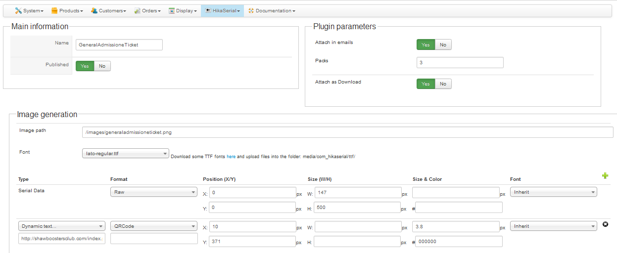

  • Posts: 6
12 years 7 months ago #131033
I'm also having a problem with the SerialAttach download. I get a download link in the email but the attached file is empty (0 bytes). I have confirmed that my template file is in the /images folder and my product file references the Plugin with #hikaserial:attachserial:2. The Plugin ID is 2. What else should I check?
  • Posts: 26354
12 years 7 months ago #131040
Please try to download the file in the HikaShop backend (when seeing the full order). If you have a blank image it can be a problem opening the file ; if it is a blank html page it can be a PHP error ; If you got a 404 page, it means that the file is not found.
If you are using a Linux server, please check the name case (better to have all in lowercase, without spaces or special characters).
  • Posts: 6
12 years 7 months ago #131050
I receive the same empty file when attempting to open it from the backend. I am able to open and view it successfully via FTP. I also renamed the file to the more Unix-friendly format, (all lower-case). My error log is clear. Same problem.
  • Posts: 26354
12 years 7 months ago #131131
Please provide a screenshot of your attach serial configuration.
  • Posts: 6
12 years 6 months ago #131210
Configuration is attached:
