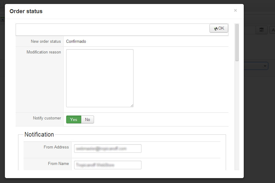

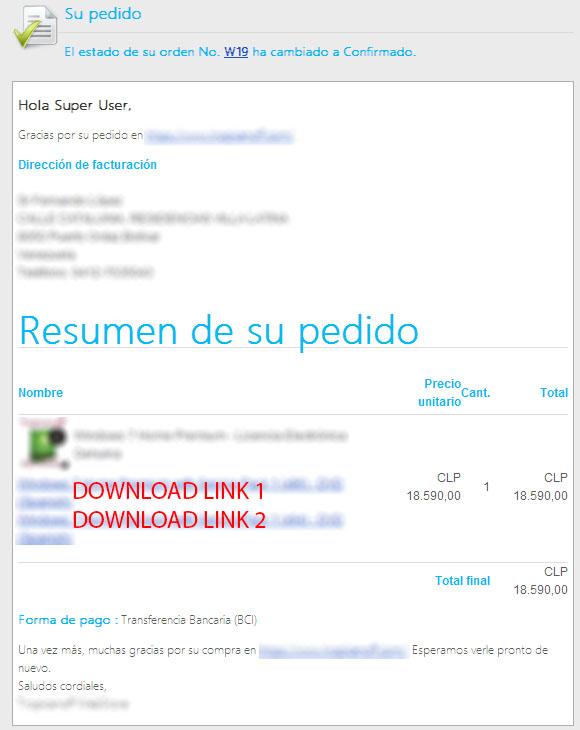

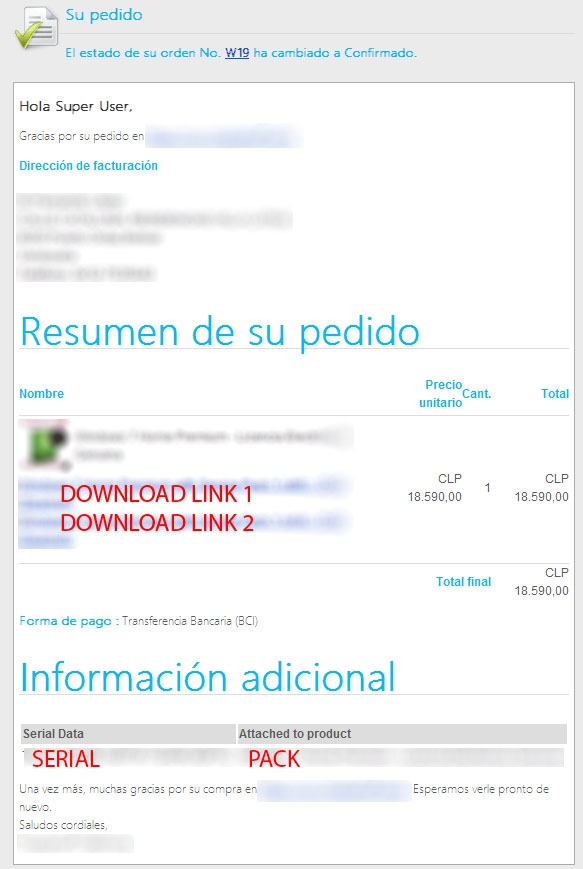

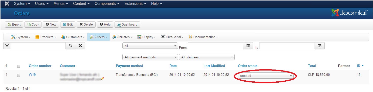

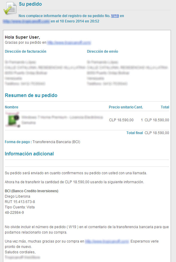

Yes, they are attached after confirmation. I will explain you the process I do:
1) The costumer buys the product (using Bank Transfer Plugin) and receive an "order created" email.
2) In the back end, I am changing it to confirmed and it allows me to see the mail will sent to the costumer. Appears the product and downloads links but nothing about serial.
3) Since he is receiving incomplete information, I am going to orders -> Selecting the order and clicking in the button 'Email' and sending again.

  • Posts: 26376
12 years 6 months ago #139280
I see.
You have to confirm the order in the order itself, not in the order listing.
In the order listing, you see the content of the email before send it. At this moment the order is not confirmed so the serial are not displayed in the mail.
The new system (that we will integrate in the order listing too in a future release) does not display the content of the email before. It will send a generic notification email after the order status modification.
If you want to send a customized email, you can use the "email" button while viewing an order, it will load the "order notification" email and you will be able to modify the content before sending the email.
