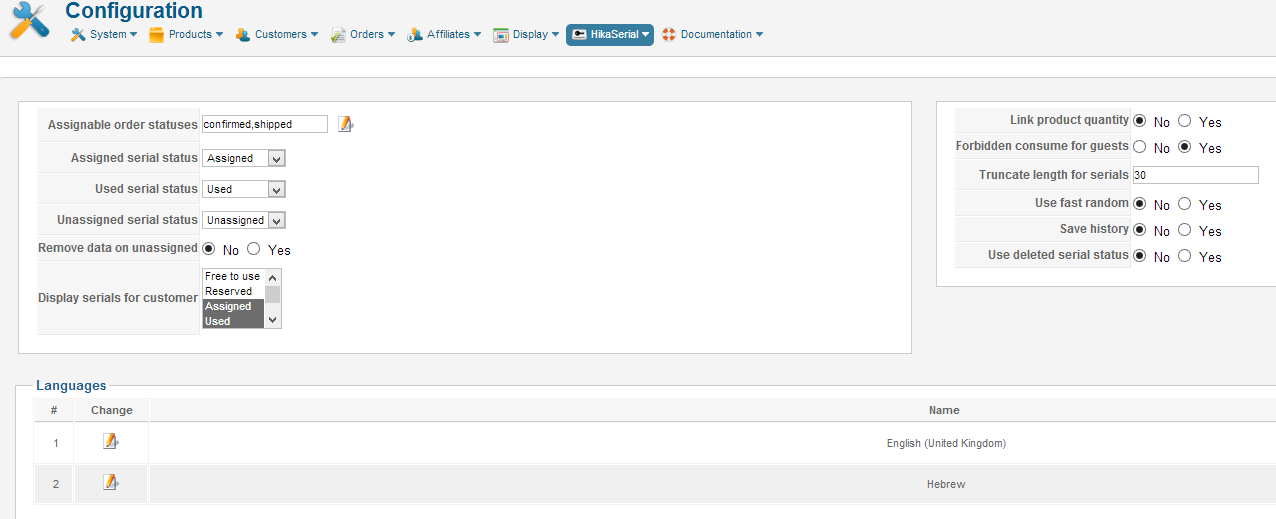

the HikaSerial configuration is at the default configuration (see attached). i did try to change the status from Confirmed to Created and back to Confirmed in order to regenerate the attachment, but then i get the PHP error.
