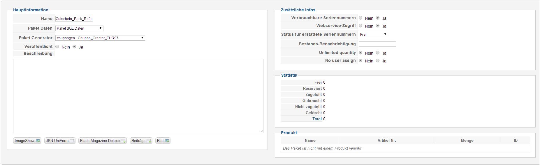

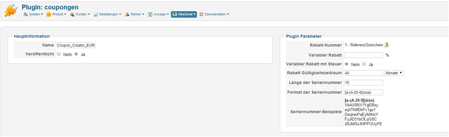

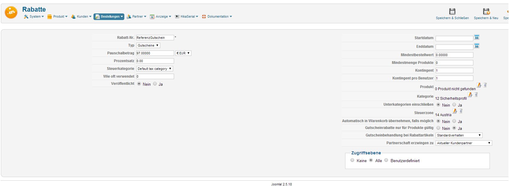

ok, i have attached some screenshots
ps: the coupon itselfs will be generated correctly. if i run the process at the newsletter-queue. the newsletter will not be sent, but a new coupon-serial is created to the correct pack.
