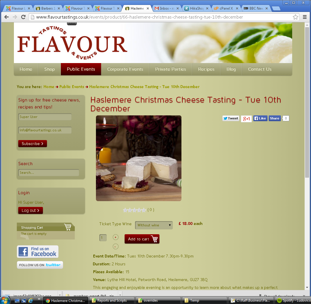

I have a product called"Event" which has two options with names "Event with wine" and "Event without wine". I would like to add the name of the option to the e-ticket so we can distinguish between the two options on the ticket.

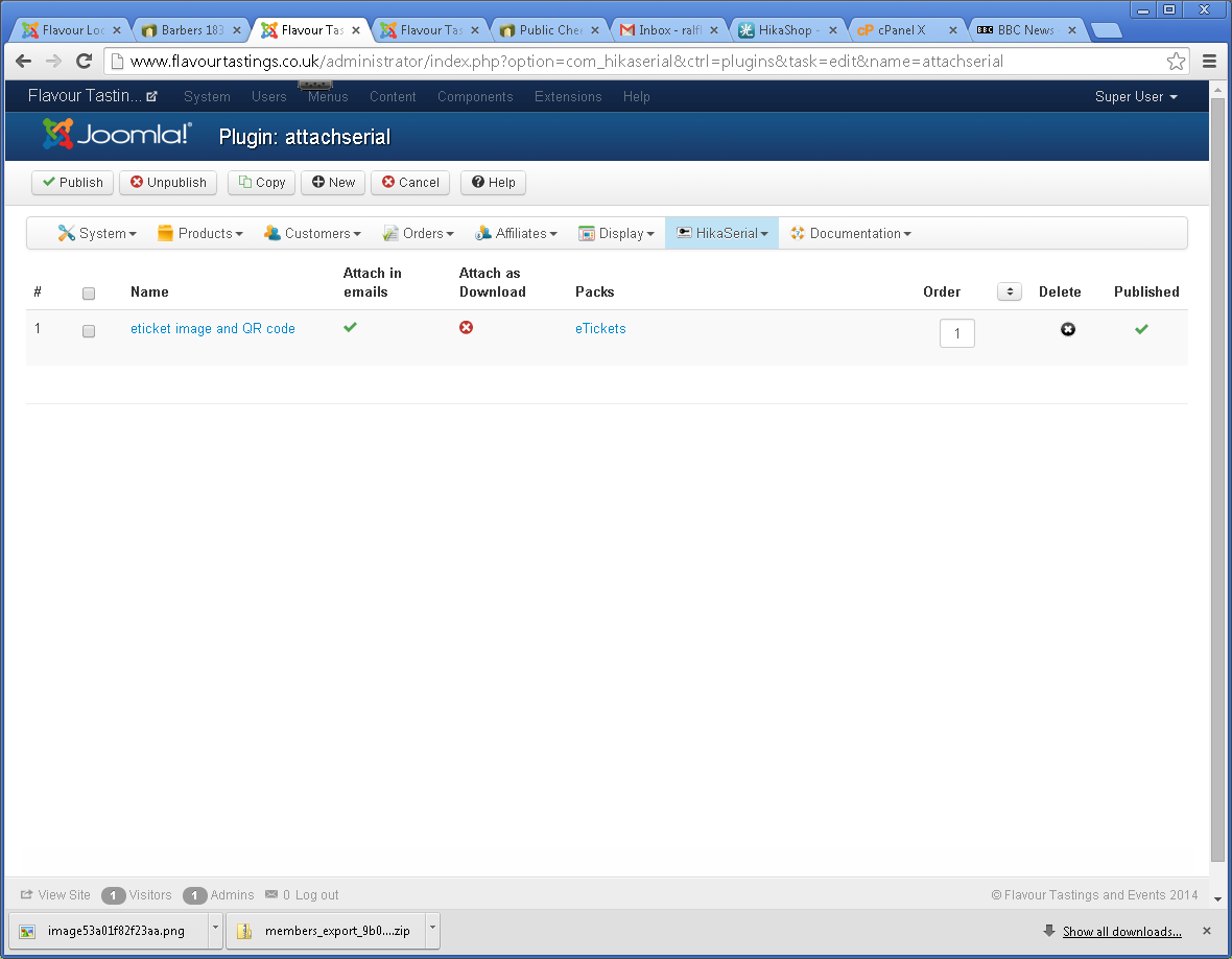

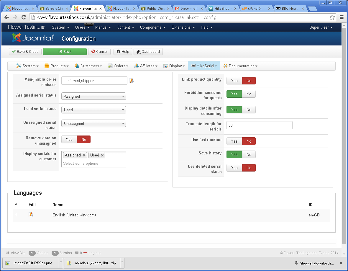

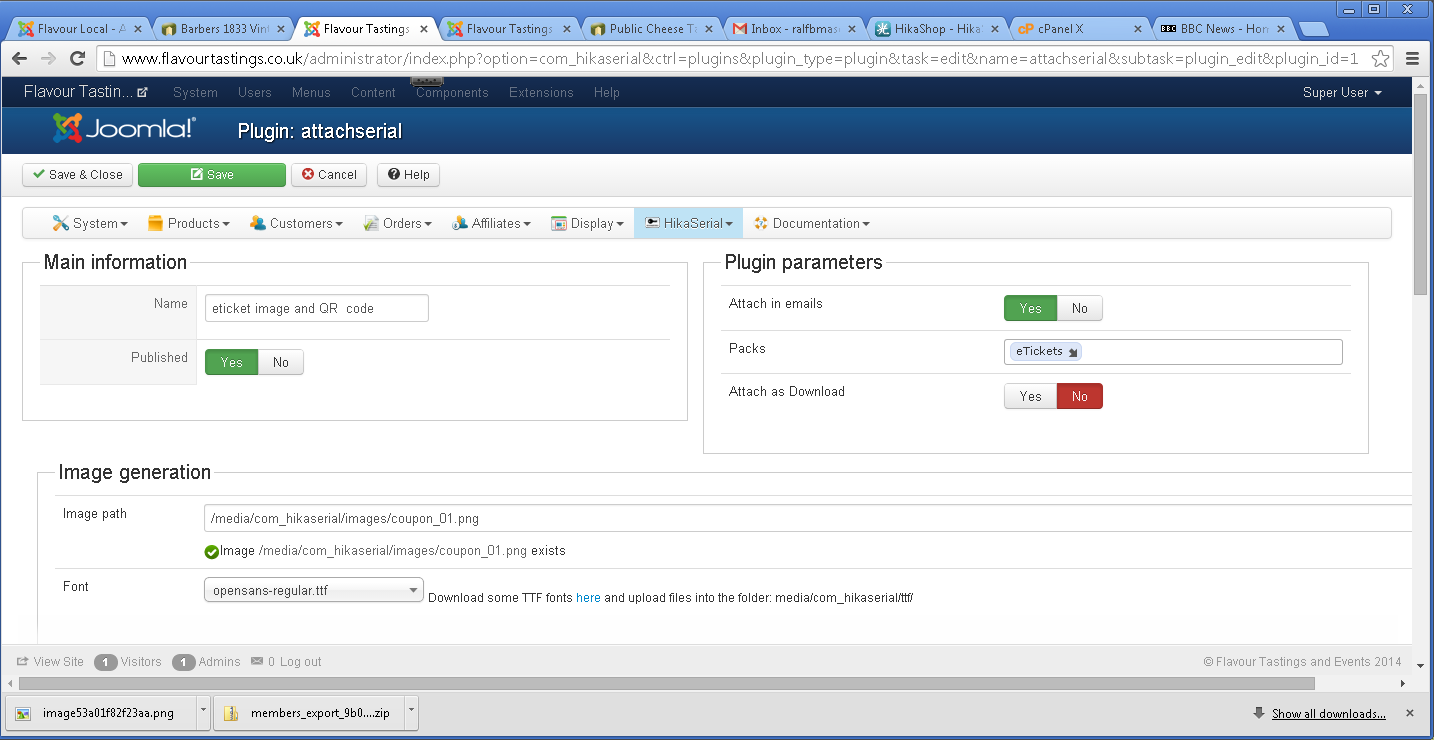

So I will require some screenshot of your "attach serial" configuration and also of your product and test order.
I have to see the most global configuration to understand the environment and why it is not working.

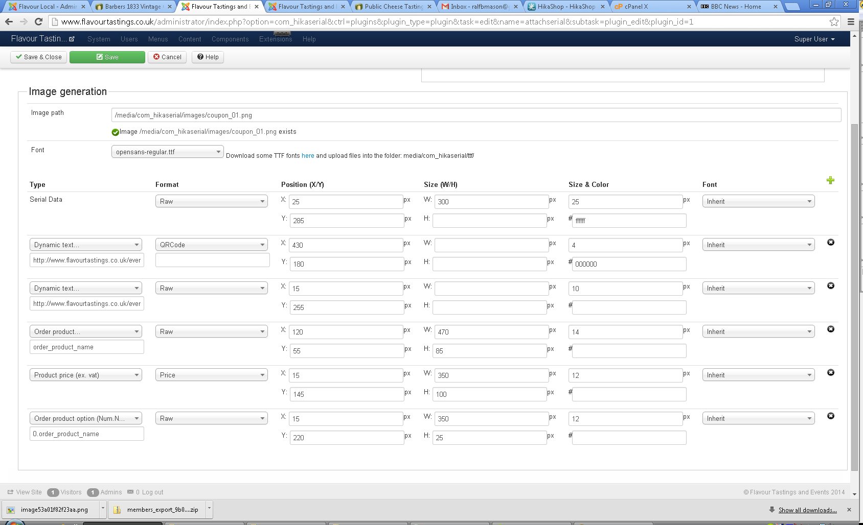

  • Posts: 18
11 years 11 months ago #160549
Hi Jerome,
Here is my configuration and the eTicket result.
Kind regards,
  • Posts: 26354

  • Posts: 18
11 years 11 months ago #160562
and the image of the ticket:
  • Posts: 18
11 years 11 months ago #160565
I'm not sure the Word document attached properly. Here are the images instead:

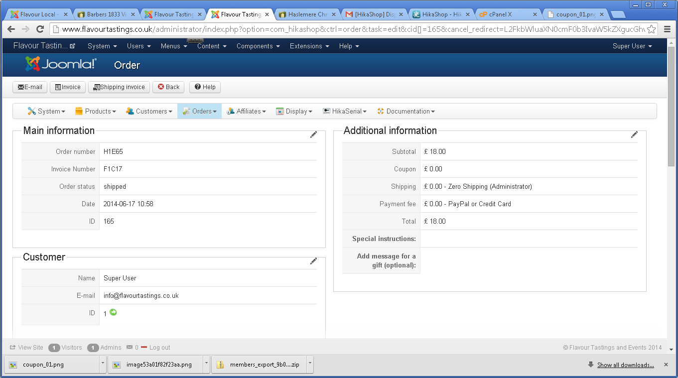

  • Posts: 26354
  • Thank you received: 4068
11 years 11 months ago #160572
Word documents are unsecured so there are not allow in the forum.

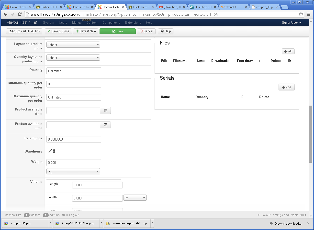

You put the screenshot of the product in the front-end but I need the product in the backend and the test order, in the backend too.
I have to be sure that the "with wine" or "without wine" is right in the order and right attached as option for the main product.

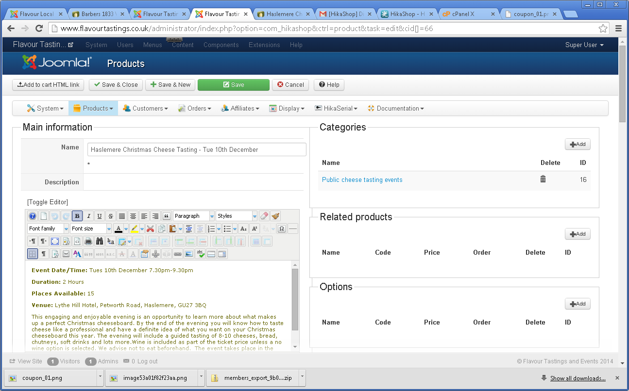

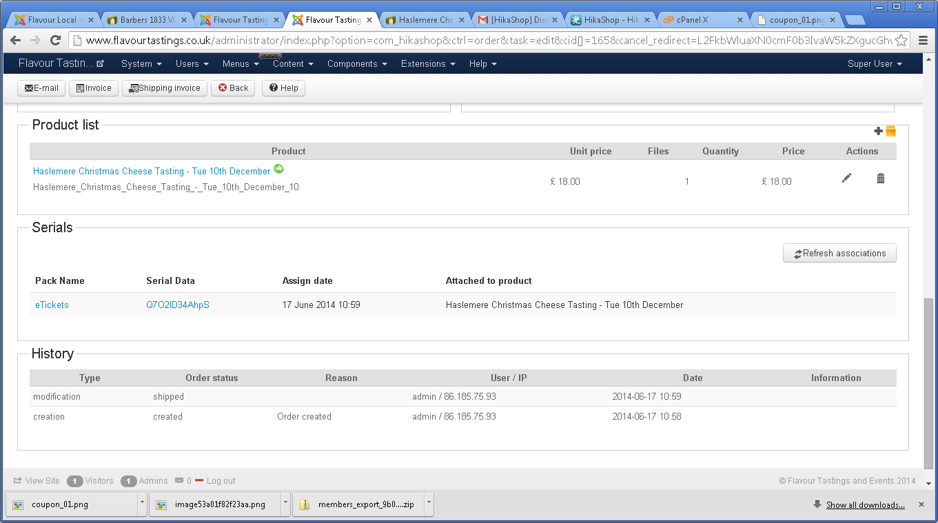

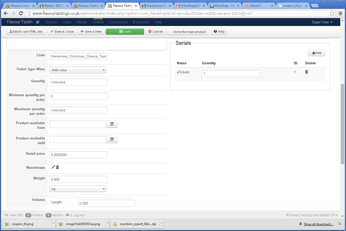

  • Posts: 18
11 years 11 months ago #160579

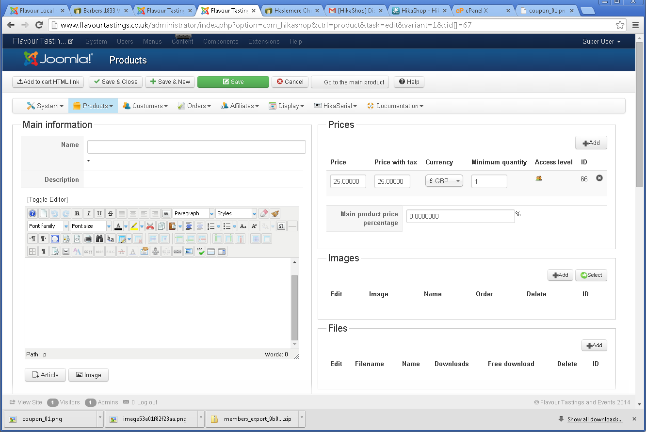

That makes sense wrt Word documents. Here are the images for the rest of the configuration:

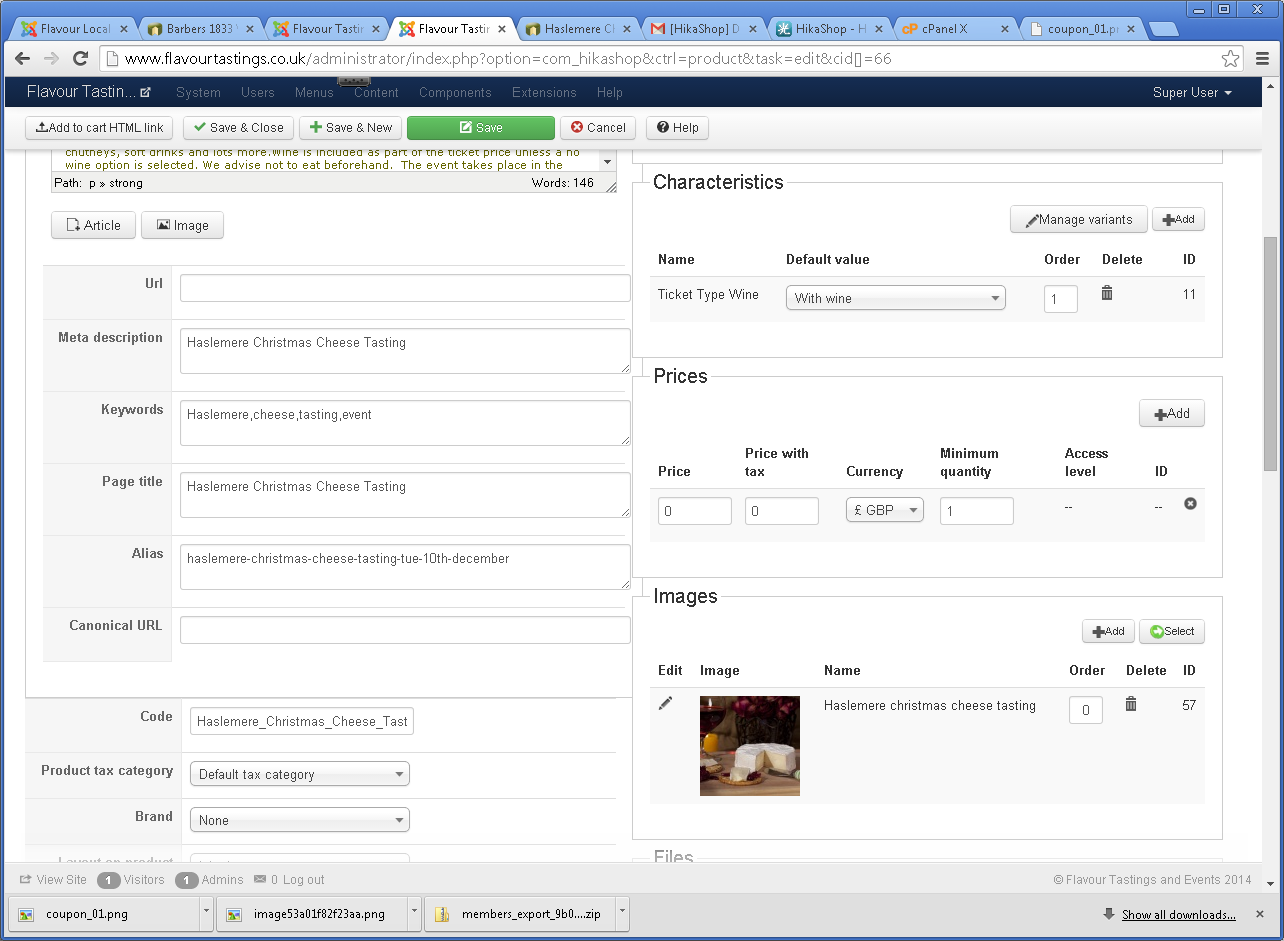

  • Posts: 18
11 years 11 months ago #160580
and for the variants:
  • Posts: 26354
11 years 11 months ago #160582
So, it's not an option, it's a characteristic.
I do not understand your question.
You are talking about variant but you are using the "order product option" and then you are talking about two options.
I am sorry but I am a little bit lost.
Apologies if my terminology is inaccurate. To clarify:
If it is not an option, you can't use the "Order product option".
You are already accessing to the order product, so to the variant of your product.
There is nothing to do.
