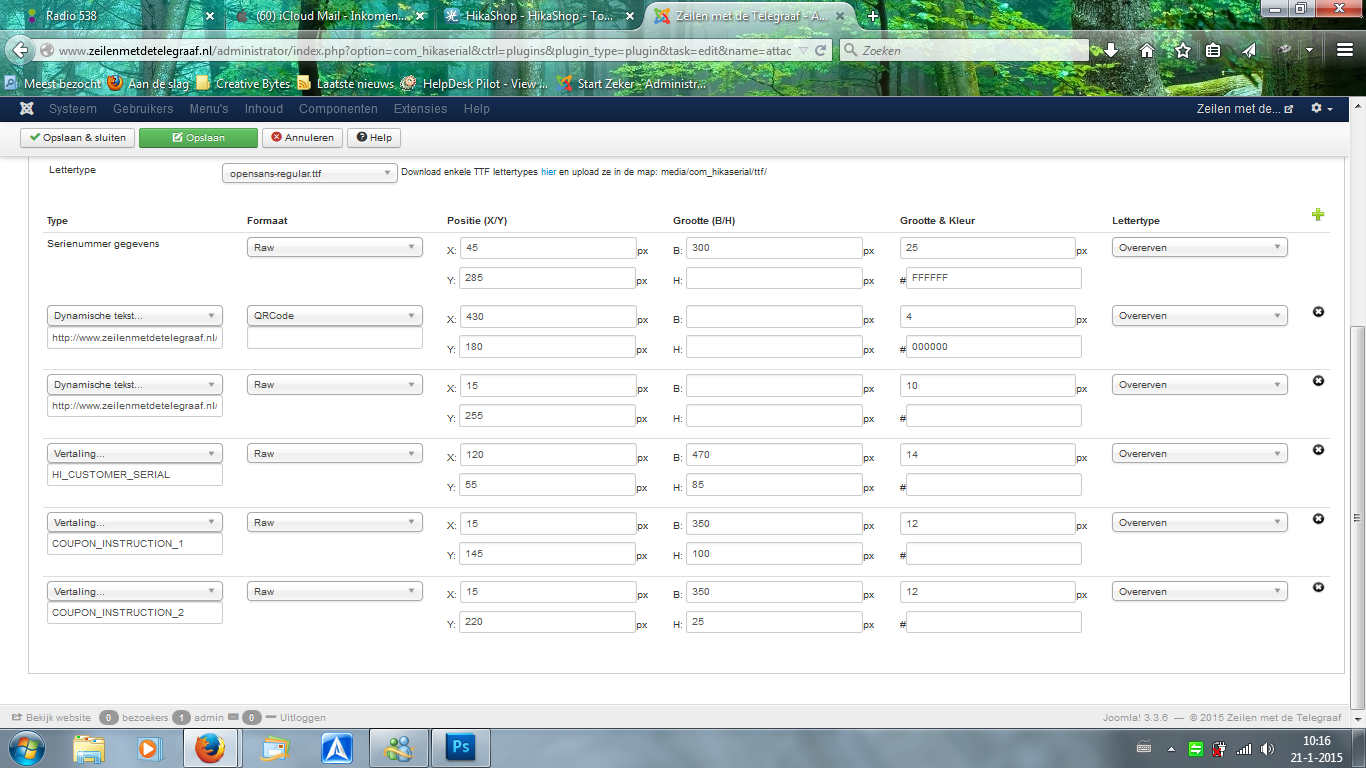

I'm trying to get a QR code to attach to the customers e-mail in order to use it as an e-ticket. I already followed the how to, including how to configure the image. Read and tried some of the forum's suggestions but I still can't get the QR code to show up.

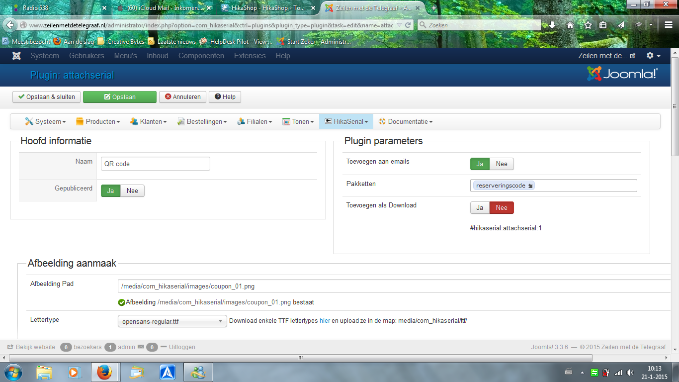

After this the random plugin, group filter consumer plugin and attach serial plugin.
I've configured the attach serial plugin using the how to and altered the path to my site instead of the example MYSITE path.

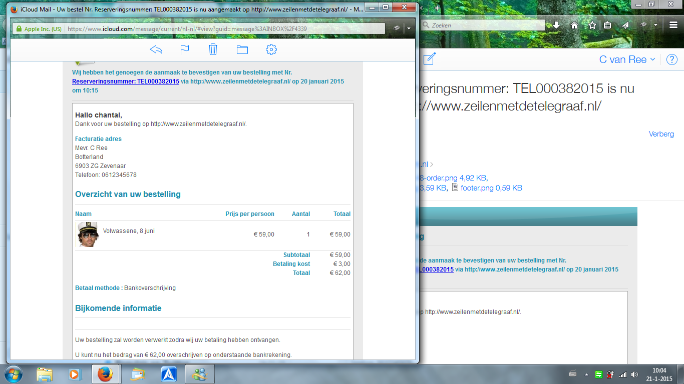

When I order this product I get an order confirmed status. Before updating hikashop and hikaserial I would get a serial attached in my order conformation (as RAW text, not QR despite of the attach serial plugin configuration. After the update I get an entire blank box where the serial used to be. When I check my order is has a assigned serial, so it seems to be something in the attach serial configuration.

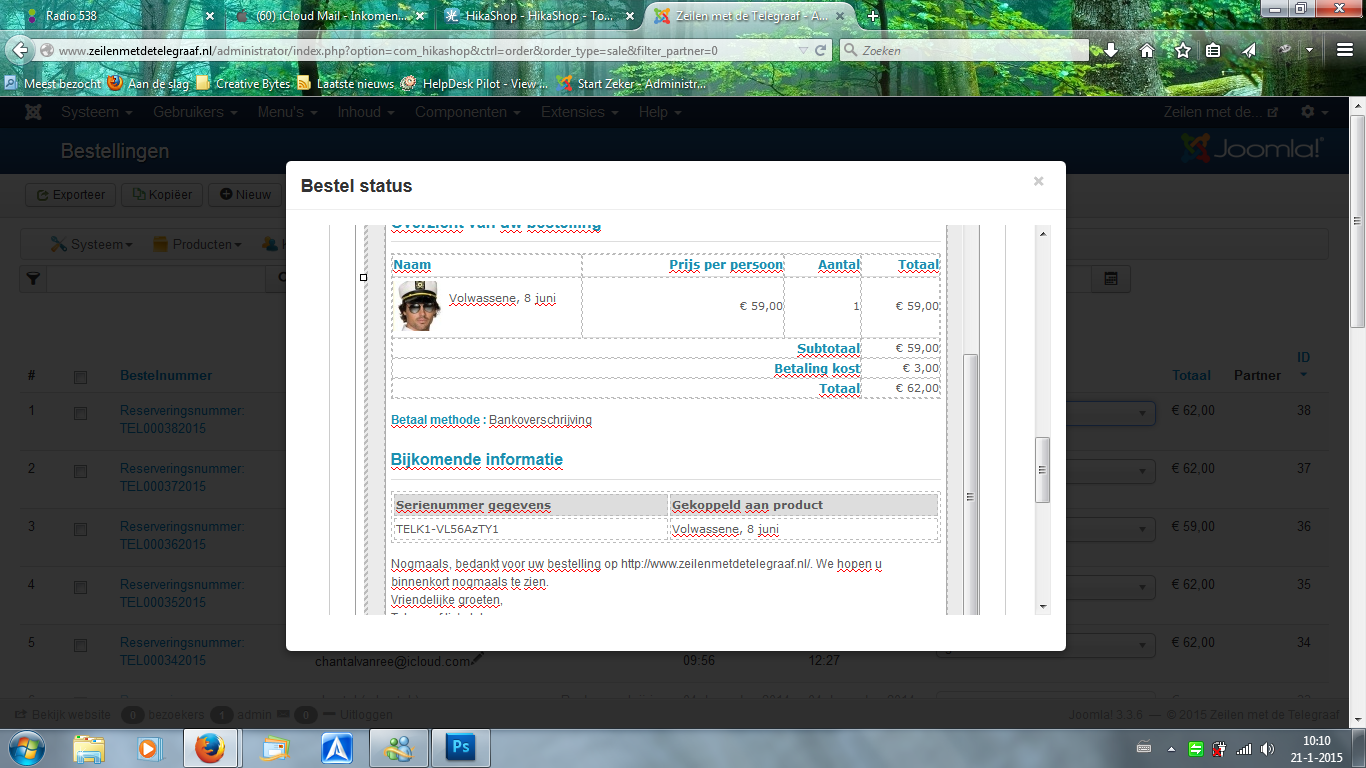

I added 2 print screens of the blank box. The first blank box is the e-mail I received after my order. The second box is the output hikasop gives me when I look at the order status and use the notify customer option.
When I look at the blank box in my email confirmation this is the output of the additional order information:
</p>
<h1 style="color:#1c8faf !important;font-size:16px;font-weight:bold;border-bottom:1px solid #ddd;padding-top:10px;padding-bottom:10px;"> Bijkomende informatie </h1>
<p style="border-bottom:1px solid #ddd;padding-bottom:10px;"> </p>
I added the configuration of the attach serial plugin. If you need any additional information please let me know!

Would it be possible to know how you confirmed your orders ?
HikaSerial is not compatible with the confirmation of the order in the HikaShop order listing (because the email is processed before the real modification of the order status, so the serial is not existing when the email is created because the order is not really confirmed, yet).
HikaSerial is compatible with confirmation thanks to payment plugin or when editing an order directly in the backend.
That could explain some of your issues.
But once the order confirmed, when you use the "email" button in the HikaShop backend (when editing an order) you should see the content of the serial and you should receive the "attach serial" image too.
If in that last screen you can see the serial but the image is not attached, I will need details about the mail system your using with Joomla.
I know that some mail plugin in Joomla does not support the inline attachment ; so we have a special option in the "attach serial" plugin (available thanks the Joomla plugin manager) to use an alternate mode for mail attachments.

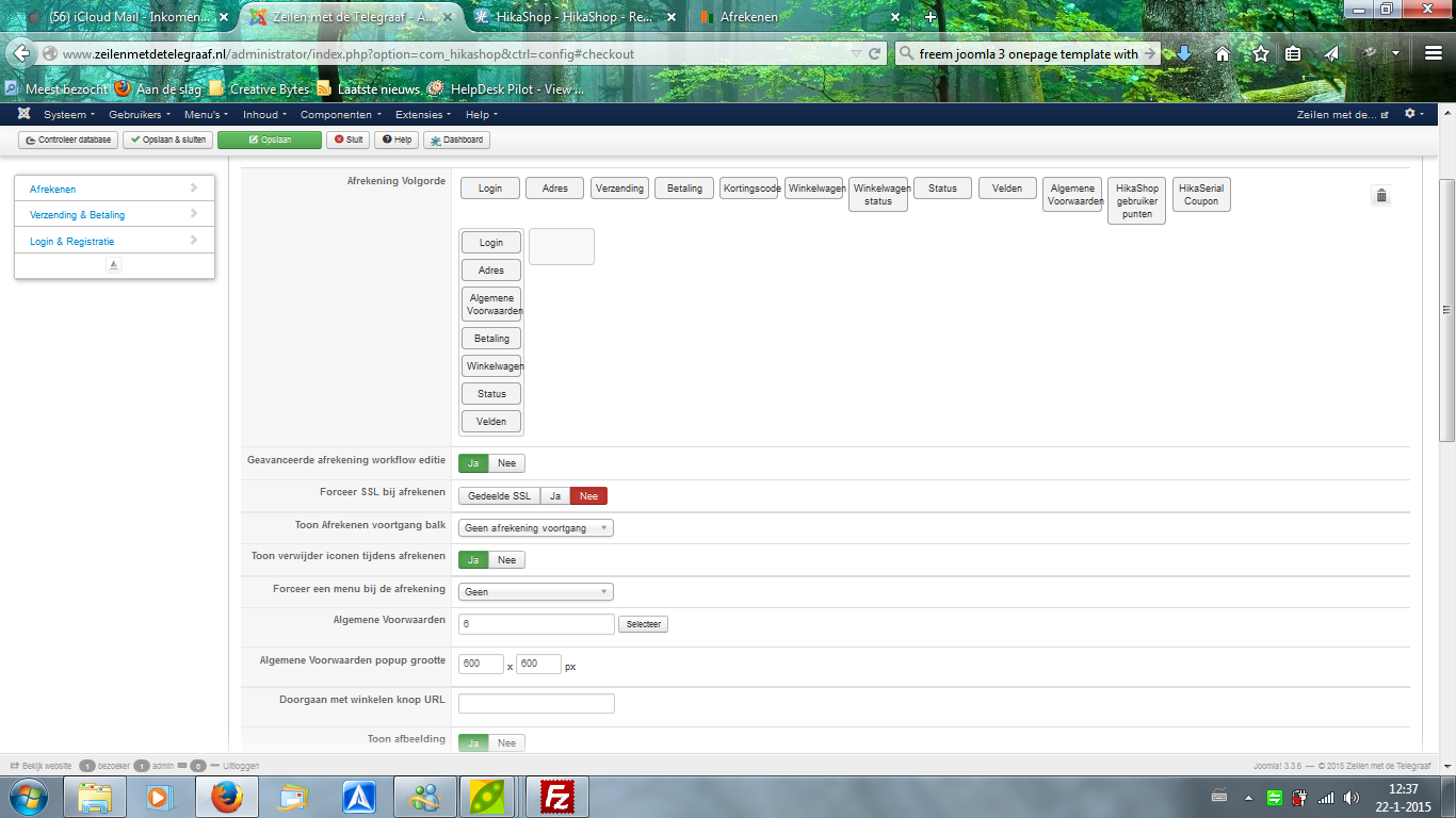

I added the workflow to this reply
The problem might be situated in the payment method then;
There are 2 payment methodes to choose from: HikaShop bank transfer payment plugin and HikaShop iDEAL payment plugin. Both are configured to create a confirmed status when succesfull

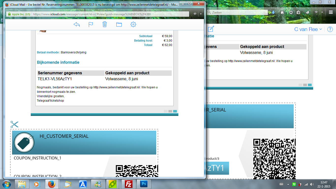

"But once the order confirmed, when you use the "email" button in the HikaShop backend (when editing an order) you should see the content of the serial and you should receive the "attach serial" image too"
What you suggest is right; I used the backend to send my confirmation e-mail again and indeed the attatch serial image is there to. However, it is located outside of the email template. When I look at the generated email in the backend the attatch serial image is not visible at all (due to it being outside of the template?)
  • Posts: 26376
11 years 6 months ago #187841
Yes the attachment is "outside" the email because it's an attachment.
Your web-app for displaying the email is display the attached image below the mail content but it will depend on the software you use to read your email.
The goal of the plugin is to "attach" the serial as an image ; as an email attachment.
When you're using "bank transfer" you have to confirm yourself the order ; so the best is to edit the order and then see to change the order status (and check the box "notify customer").
For the iDEAL plugin, it should confirm the order itself and send the confirmation email ; with the serial and the image attachment.

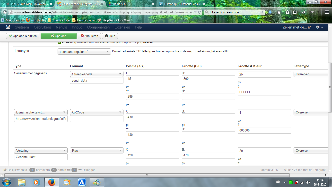

Besides the QR code, I wanted to attach a barcode. I switched the RAW serial data form the example for the barcode option. Output does not give me a barcode. Can you point me in the right direction?

If you want to display a Barcode, you need to provide a data which is compatible with the EAN-13 format.
