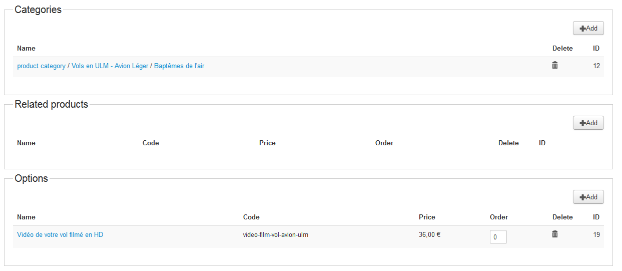

  • Posts: 79
11 years 3 months ago #200095
In my project, i have several products in a parent category.
I've created a separed category for and add the optionnal product into it.
Then, i've assigned the option, here it is a "video film" that customer choose or not with a flight tour.
Here is a capture of "20 minutes flight tour" product .
The option has been assigned to it.
A this stage i do not see what "X and "Y" could be.
Many thanks
Last edit: 11 years 2 months ago by lcoulon.
  • Posts: 26376
11 years 3 months ago #200100
You just have one option, so the best will be to use
0.image
in order to display the main product image of the "video de votre vol filmé en HD"

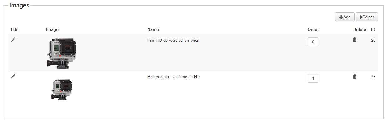

  • Posts: 79
11 years 2 months ago #200129
I think i got it.
Because i have only one option set in my products, then X becomes 0.
If i'm not wrong :
image.0 would be the first image assigned for that option.
image.1 would be the second image.
I get expected result if i set in attachserial pluging 0.image.0
but the first image is not the one i want to use, in my case i would like to display the second one :
However, if i set 0.image.1, then the result displayed is outstanding.
Instead of displaying the second image ( small camera picture seen above ) there is a totaly different image displayed ( that comes from another category image )
Did i miss something again ?

  • Posts: 26376
11 years 2 months ago #200153
@lcoulon
Regarding the code of the plugin "attach serial", it load the images for the product option and if the product is a variant, it will also load the images of the parent product.
The order of the images should place the variant images before his parent images but I don't see why it could load images from a totally different thing because there is a filter on the "file_type" to only load product images.

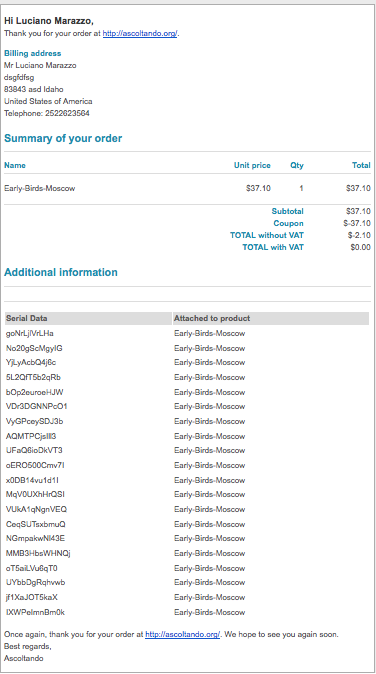

  • Posts: 5
10 years 10 months ago #213415
This is what I get as an emasil after purchasing an item from my cart.
  • Posts: 26376
10 years 10 months ago #213416
I don't see any link with the current thread.
Please open a new one for your issue.
