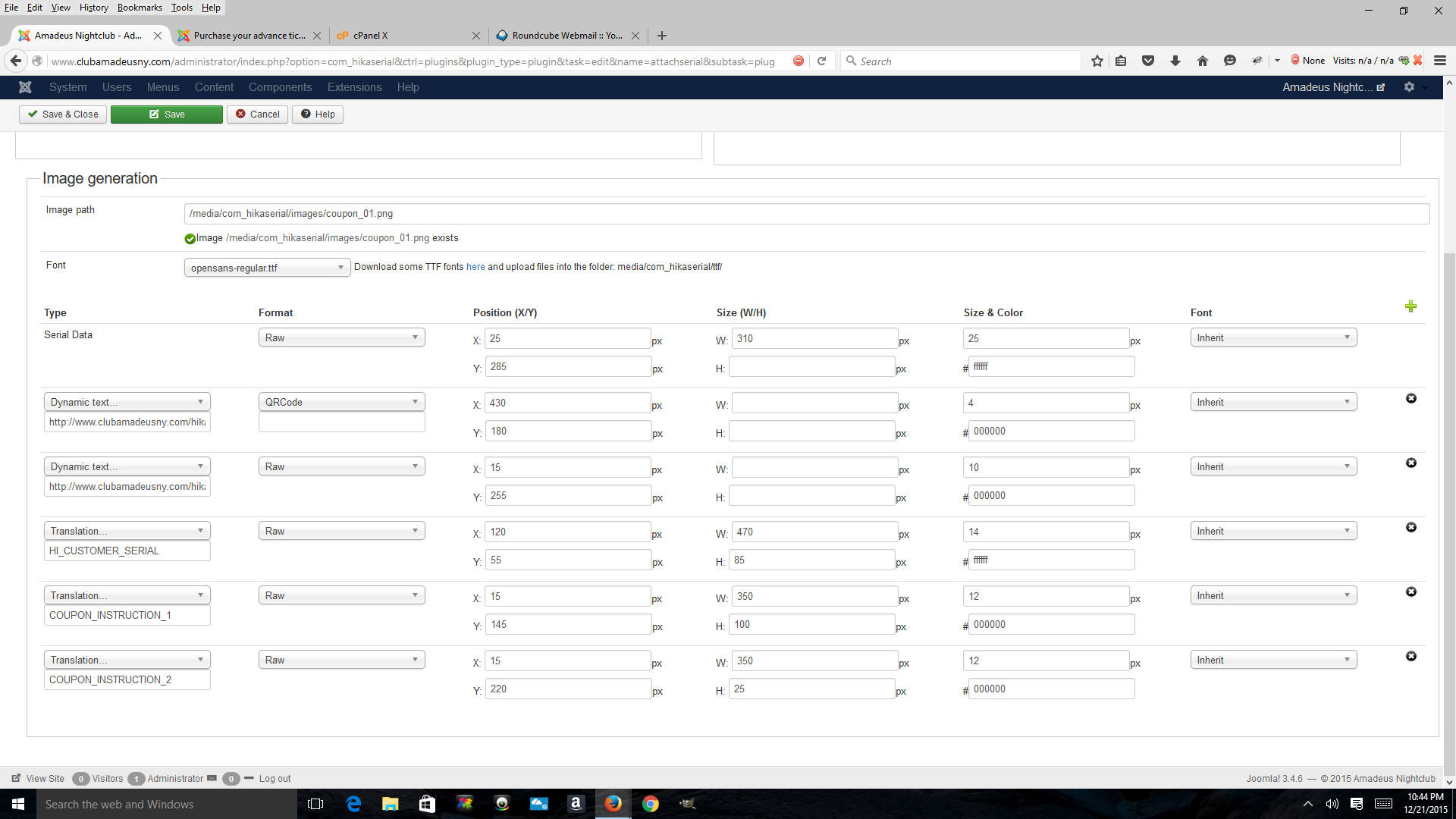

I setup my attach serial to email qr code and it works fine. I see the qrcode image (for Etickets) but I am stumped on how to configure the scanner (iphone QR Reader) to send the scanned qr image to my website to check the ticket.
I am logged in with my iphone browser but when I scan the image it take me to my homepage.
Any help would be appreciated!
Thank you

  • Posts: 8
10 years 7 months ago #224816
Thanks for the reply! Here's an image of attach serial plugin setting:
Dynamic text:
http://www.clubamadeusny.com/hikashop/product/{order_product.product_id}-{order_product.order_product_code}

  • Posts: 26376
10 years 7 months ago #224855
Regarding your website and the URL of your products, it looks partially good.
In HikaShop I think that you're using the canonical URLs ; so the link that you generated for the product is not the right one because the last part is based on the "product name" (in a SEF mode) and not on the "product code".
So I think it will be easier for you to use
http://www.clubamadeusny.com/{product.product_canonical}
to get the real URL of the product.
