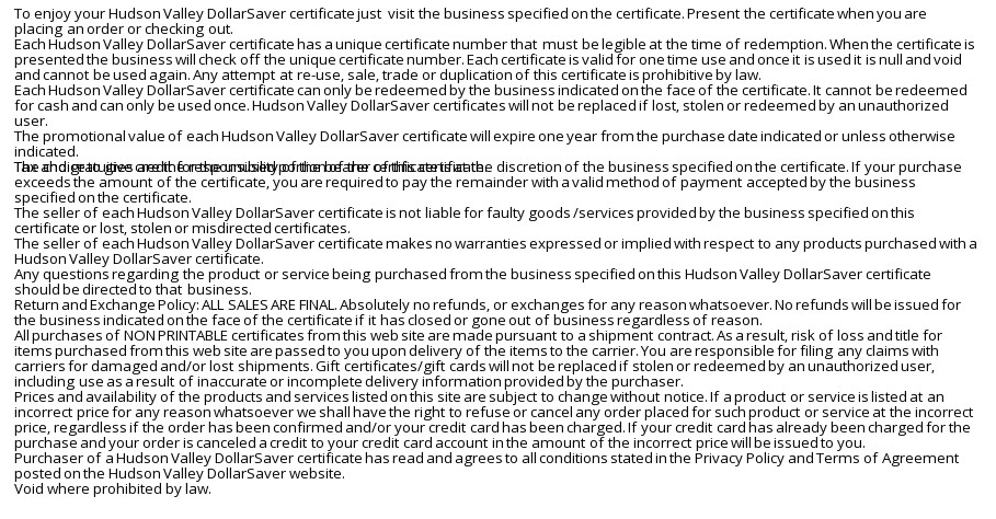

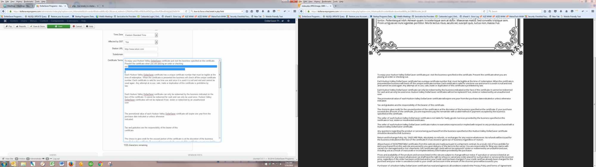

I have to include terms and conditions on the generated certificates, and need to insert page breaks between the paragraphs to make them more readable. The only way I found I could do this is to insert a huge number of spaces between each paragraph in the text field to force the next paragraph onto a new line. There must be a better way to achieve what I'm trying to do. Any thoughts? typing in two or more <enter> does not have any affect. Using a WYSIWYG field type only shows the html coding on the certificate.
The attached file shows the entry field on the left and the bottom of the certificate and the terms on the right.
Thanks!

10 years 6 days ago #241514
Thank you, but unfortunately it didn't seem to have any effect. Please see attached. Each paragraph should have a blank line in between. The shortest one in overlapped by the one below it.

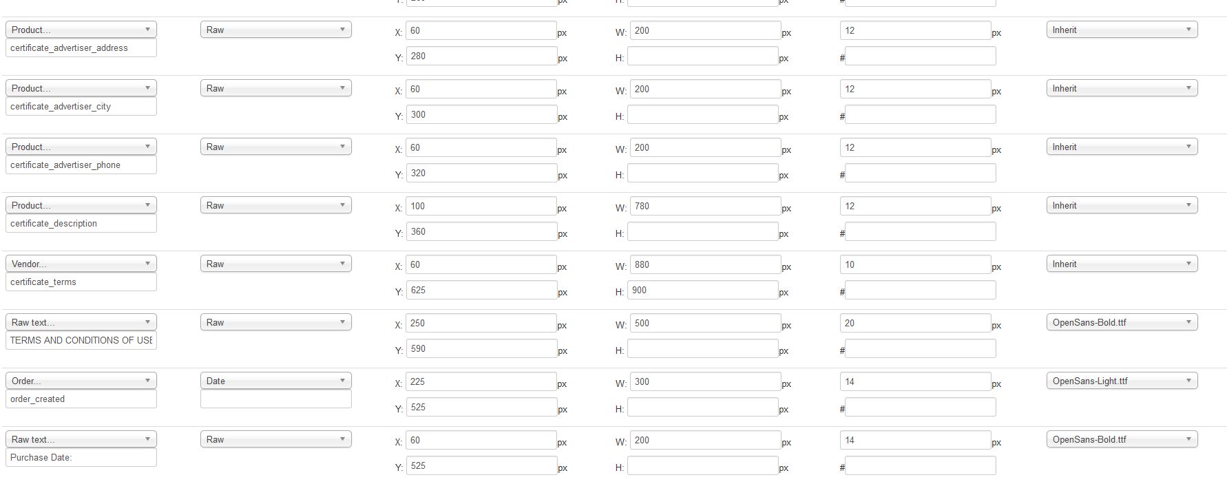

Can you please confirm that you have specified an height and a width in your "attach serial" configuration ?
  • Posts: 296
  • Thank you received: 7
  • Hikamarket Frontedition Hikamarket Multivendor Hikaserial Standard Hikashop Business
9 years 11 months ago #243404
Sorry it has taken me so long to get back to you. Took a much needed vacation. Yes the the height and width for this is set in the AttachSerial configuration. Any more thoughts on it?

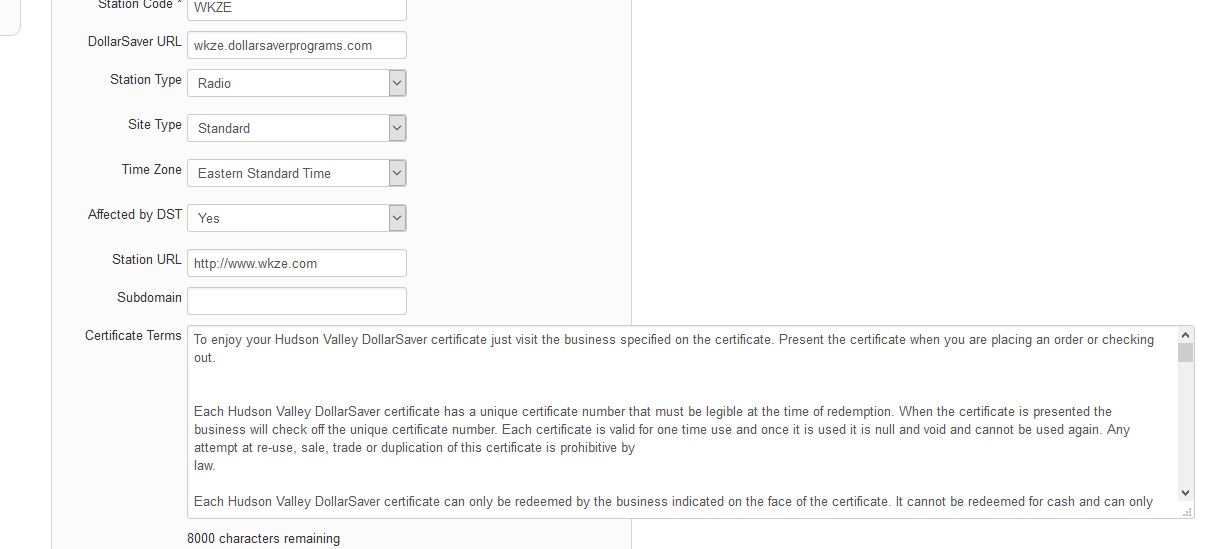

Would it be possible to have a (partial) screenshot of your "attach serial" configuration in order to see what you have set ?
So I could see to reproduce your issue.
  • Posts: 296
9 years 11 months ago #243502
Here are the screenshots from my configuration.
The field I'm having problems with is the "Certificate Terms"
thanks for the help
