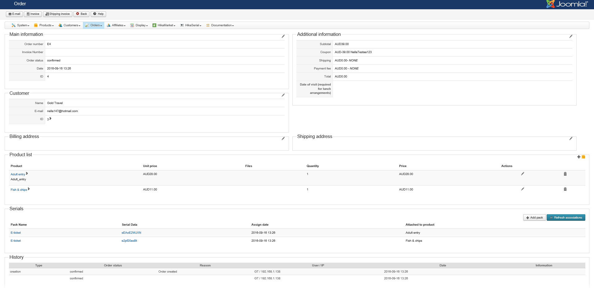

I do have a serial visible in the backend order details, and all orders are listed as confirmed. The serials are linked to the correct pack and I have set these to be attached as download.

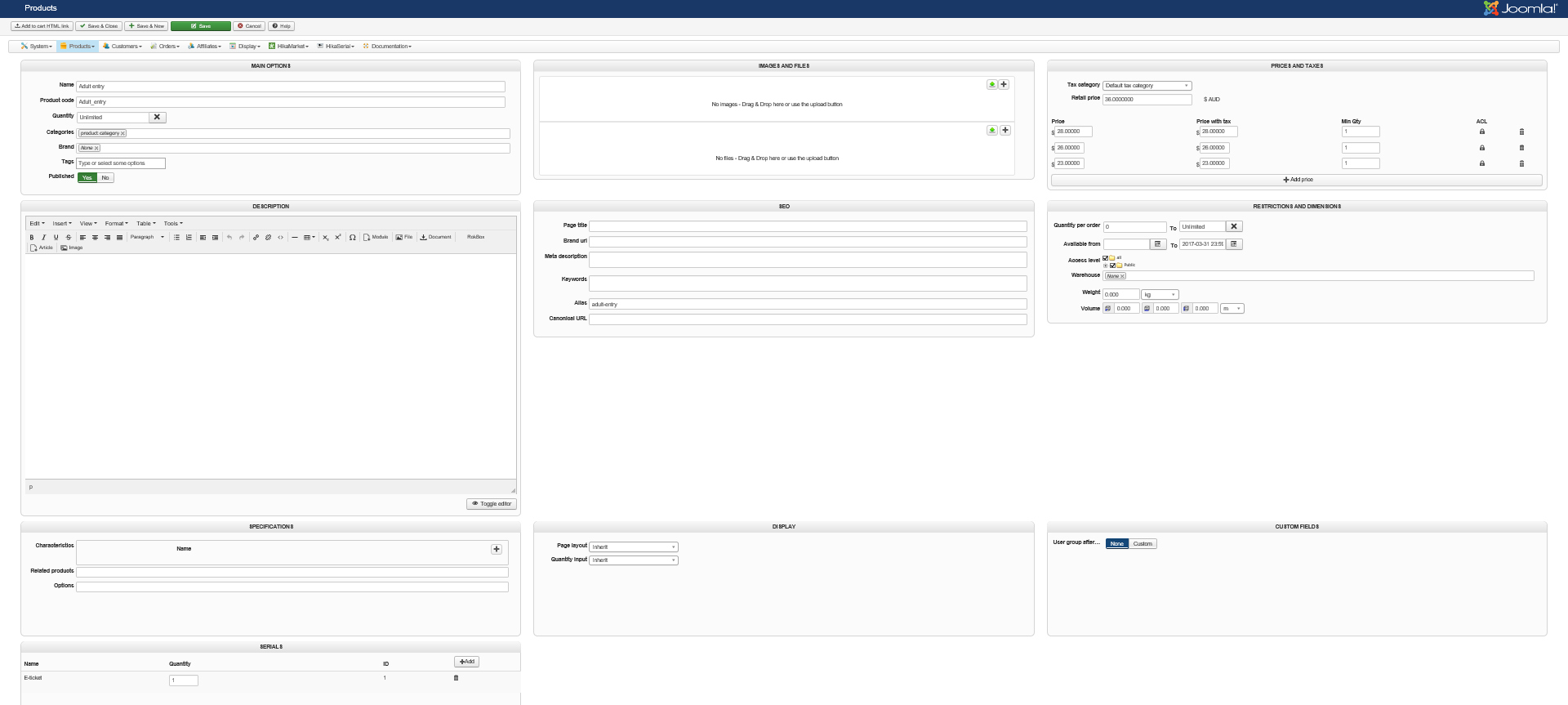

I have also attached the e-ticket serials to each product, but I'm not sure if this is the same as "creating a virtual product file for your products with serial"?
Please see the attached screenshots for illustration.

You're configuration and your order looks okay.

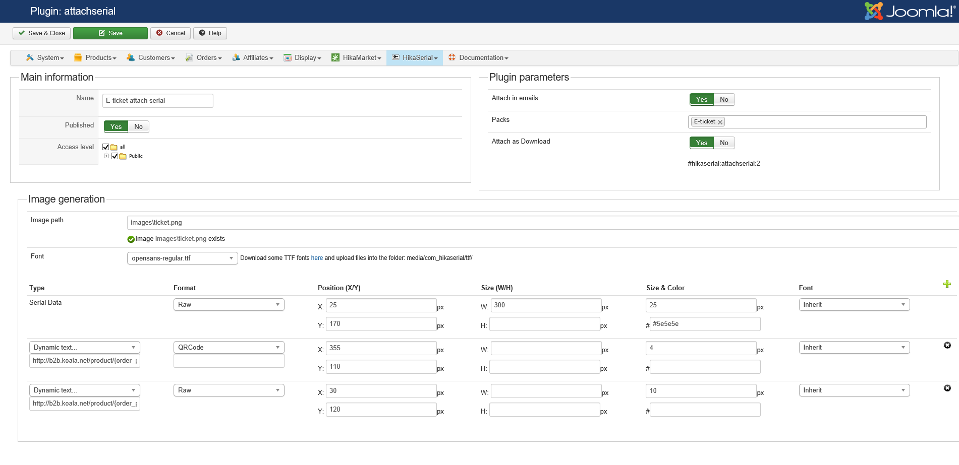

Thank you for the tips, turns out the Joomla side of the Attach serial plugin wasn't enabled so I enabled it and can now see the images attached in order emails.

Hi again Jerome, I have played around with the e-ticket customisation using this tutorial
www.hikashop.com/support/documentation.h...ns-attachserial-form
Is there a way to have the purchased product name appear on the ticket? I tried using the dynamic text type and also translation, but haven't been able to figure out what the url or namekey should be.. Am I even on the right track?

in the list of the types you will find the "Product..." which allows you to display the elements from the "product" table.
By putting the value "product_name", you will display the data from the "product" field "product_name".
If you use a dynamic text, you have to use a tag, like
{product.product_name}
