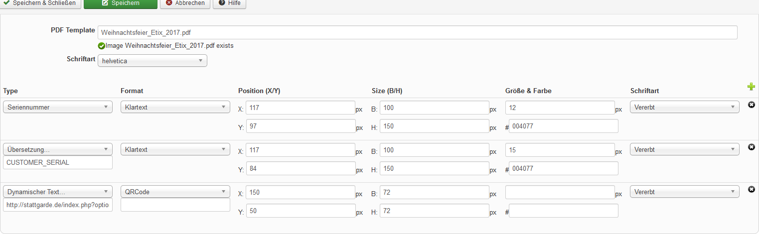

Hi!
I tried to configurate the PDFSerial. There is no problem to integrate the serialnumber or the customers name. But I do have problems with integrating the QR code. I do use the dynamic text (like I do with the AttachSerial) and set it to "QR Code" into the field below I copied the following:
stattgarde.de/index.php?option=com_hikas...k=consume&hikaserial [serial_data]={serial.serial_data}&hikaserial[format]=html&tmpl=component
When I set the order on "shipped" to create the email with the PNG and PDF I get the following error:
Fatal error: Cannot redeclare class QRcode in /homepages/36/d78750134/htdocs/relaunch_2017/joomla3x/administrator/components/com_hikaserial/inc/tcpdf/include/barcodes/qrcode.php on line 100
What might be the mistake?
When I chance it to "barcode" it works. But I do need an QRcode.....
