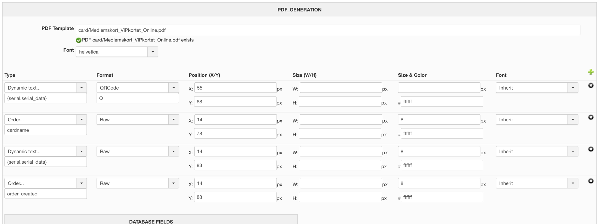

5 years 4 months ago #330749
I'm using PDFSerial:
  • Posts: 26376
5 years 4 months ago #330750
Thanks for the precision ; I was looking in the wrong plugin source code !
If the PDF library you're using does have the "write2DBarcode" function, then the color might not be handle correctly.
It looks like the library is asking for the color in decimal format while the lib is sending the data in hexadecimal.
Thus, it requires a little conversion of the value before sending it to the PDF Lib.
