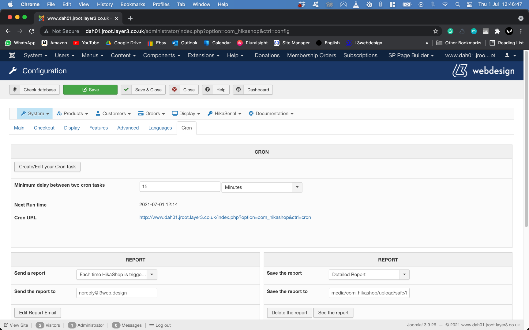

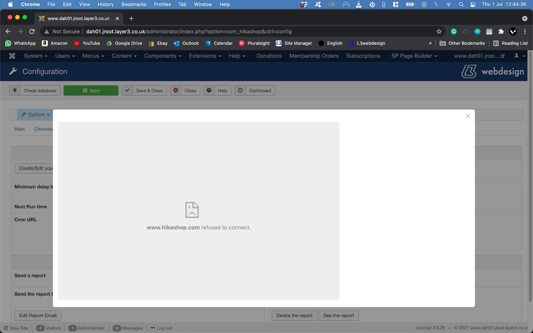

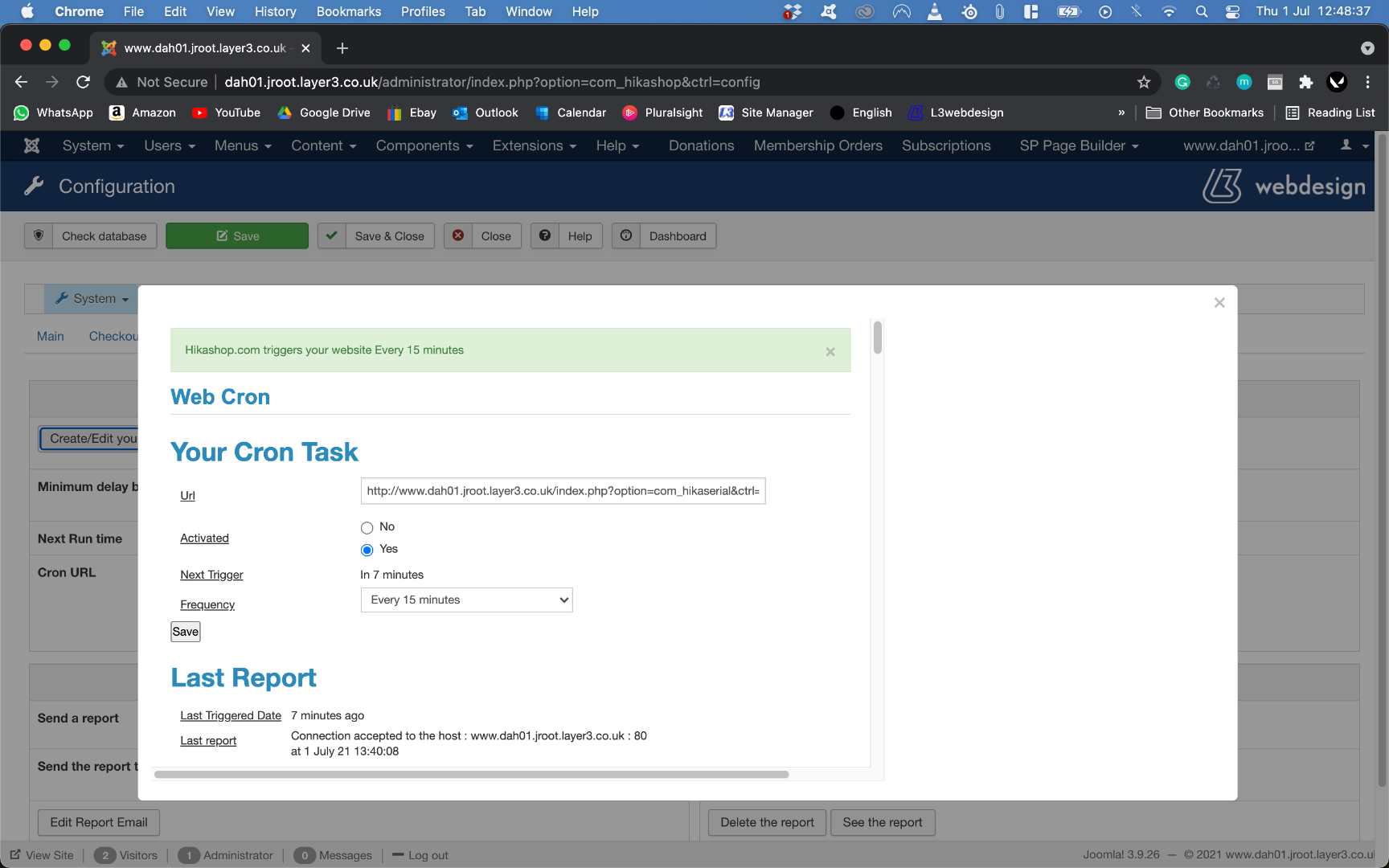

1) When i enter the "your cron task" URL ( www.dah01.jroot.layer3.co.uk/index.php?o...trl=serial&task=cron ) and hit save. I get www.hikashop.com refused to connect. please see attached -
When I do a Joomla save (the green button) the cron URL is still set to the default - please see attached -
However, when I go to edit my URL again I can see the one that I entered - please see attached -
Whenever I click save I get the same www.hikashop.com refused to connect message.

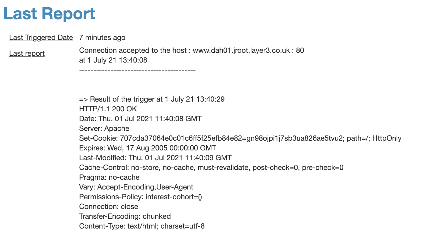

2) In the last report, The result of the trigger the timestamp seems to be CEST - please see attached -
Could I change this to BST or GMT?
Thanks.
  • Posts: 26354
  • Thank you received: 4068
4 years 11 months ago #334091
If you have an HikaShop cron ; use the HikaShop cron.
The HikaSerial cron URL is when you're using the manual method (from the documentation I gave previously).
If you have issues with the HikaShop cron system, please open a new thread in the HIkaShop section of the forum.
