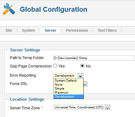

13 years 2 months ago #110588
As Nicolas said, you have to set the error reporting too.
Otherwise, you will have to read the PHP error log in your web hosting.
  • Posts: 32
13 years 2 months ago #110591
I´m sorry i was enabling system > debug system :blush:
Now it´s like your picture

13 years 2 months ago #110757
You can try to use a lesser error reporting level like "Maximum" or "Simple".
The Strict Standards notices you have are not in HikaShop so we can't fix it in our packages.
You have to activate the error reporting only if you are in a debug process.
When the debug process is finished, you have to remove the error reporting, so the website won't display the PHP notices. It is highly recommended for production.
