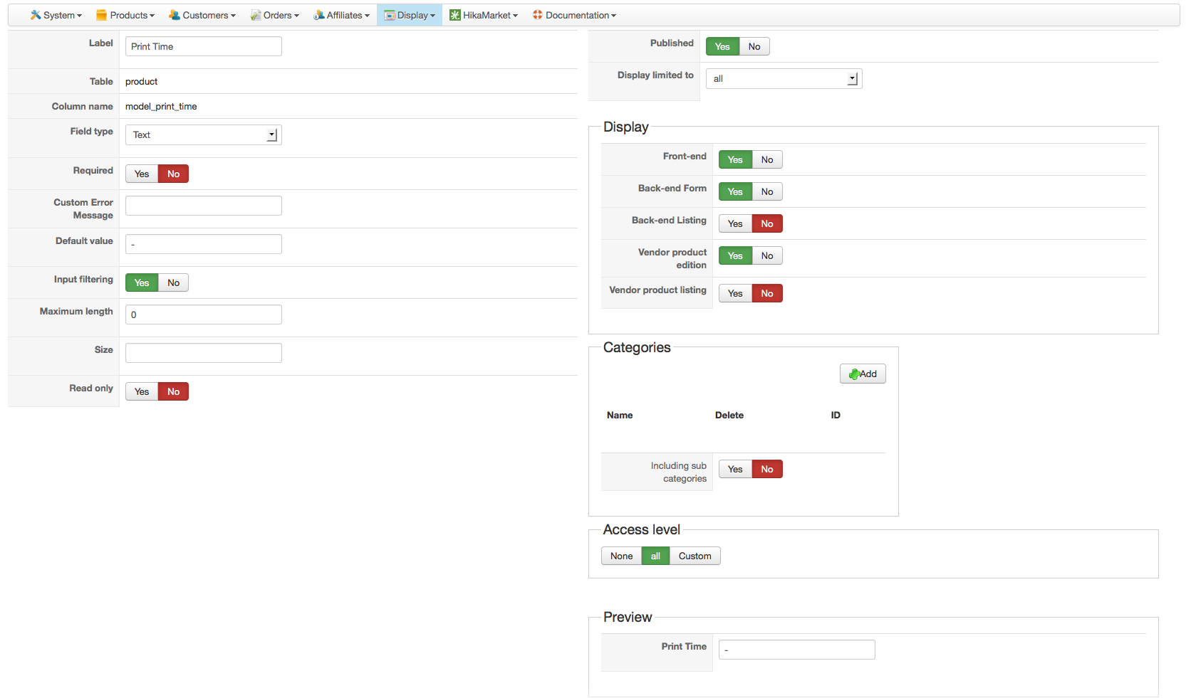

12 years 10 months ago #128338
Would it be possible to update to HikaShop 2.2.2 ?
I think that the problem is linked with the mass-action system because it is clearly not logical that the data are present (and null).
If the custom field is not available in the front-end, the data shouldn't be present in the object used for the save.
Can you send me a screenshot of your custom field configuration (the one which give you the problem).
I want to be sure that I have the same configuration on my side and the problem is right solve using the latest versions.

The settings are below, the only difference is that now I have the setting Display-> Front End set to yes instead of no.
