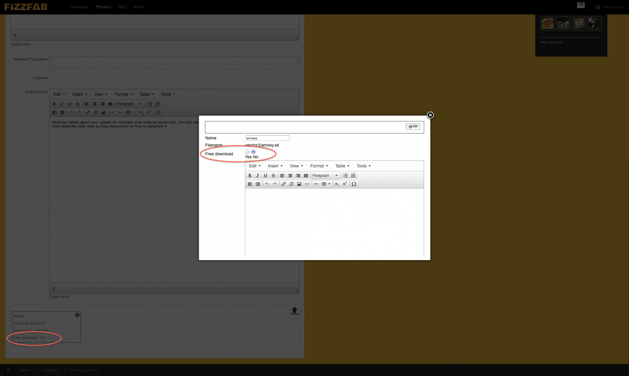

Finally got around to updating to com_hikamarket_multivendor_1.3.1_2013-11-19 and the issue still persists.
Please see attached screenshot for better explanation of issue.
Note that the default value is set to free download and this is indicated on the dialog in the file upload window, however when the item is saved the free download set to of. Additionally If I edit the file immediately after uploading it the value is set to off as shown in the screen shot.

12 years 9 months ago #133177
Thanks for the access.
I got it.
Well, it was not that the "free download" is not saved, it is that the option to set new uploaded file as "free download" which does not work as expected. The display was right but not the database.
If you want to put the fix, you have to edit the file "components/com_hikamarket/controllers/products.php" and replace
				$file->file_ref_id = $product_id;
				$file->file_path = $r->name;
By
				if($file_type != 'product')
					$file->file_free_download = $config->get('upload_file_free_download', false);
It will save the data in the object just before the save so, it will be good.
