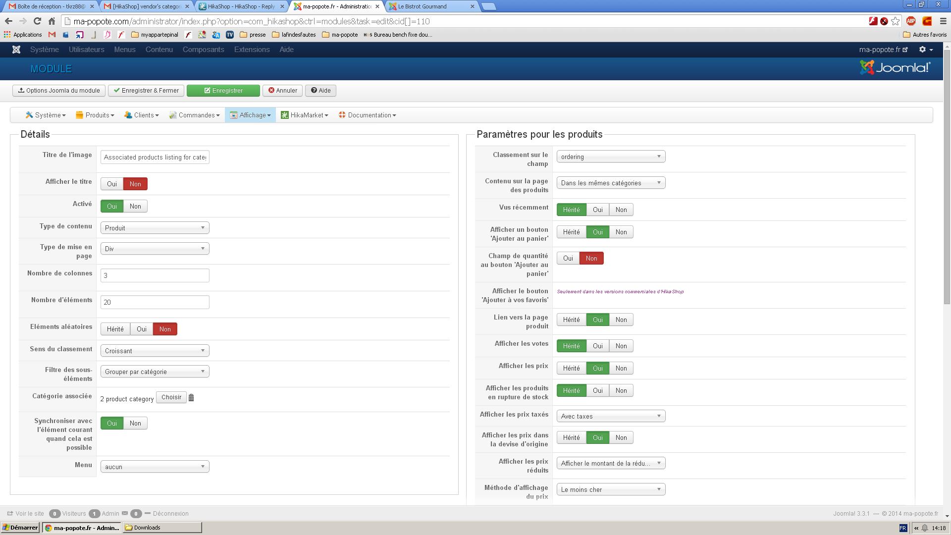

In your product listing module (HikaShop > Display > Content modules), you have to change the option "Sub elements filter" to "group by category".

12 years 2 months ago #163526

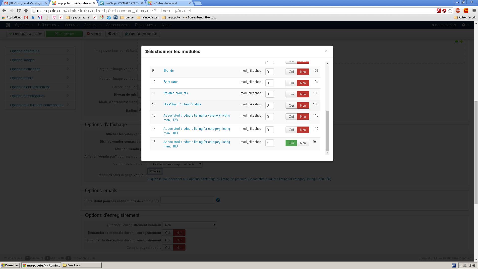

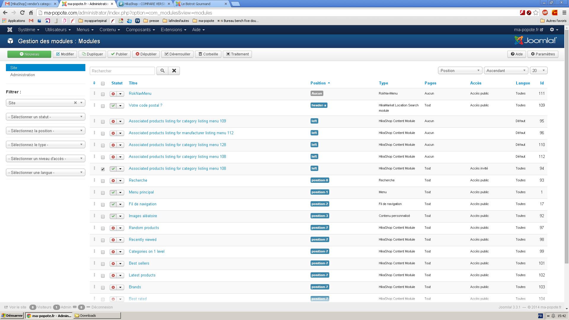

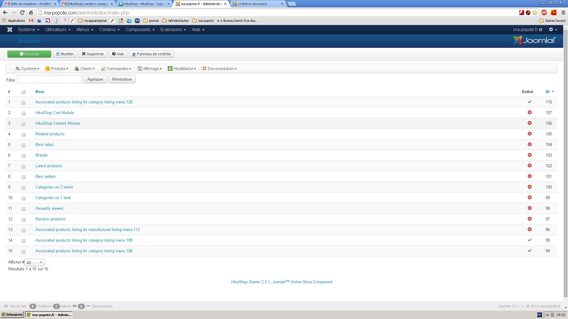

You're editing the module "110", which is a product listing module but not the module which is display under the vendor page.
You can see in your HikaMarket configuration that the module displayed under the vendor page is the module "94"
So you have to edit the module 94 to see the differences.
And regarding the vendor page : "index.php/la-page-des-vendeurs/vendor/show/2-le-bistrot-gourmand" it looks like the option is set because I can see the category title "les plats".

12 years 2 months ago #163548
I am sorry but I don't see the meaning of your screenshots.
And I don't know what's wrong with your current configuration, what is not resolved.
Would it be possible to have some explanations ?
