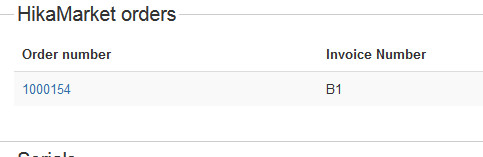

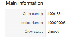

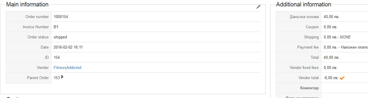

First shortly what happens now when vendor sells is that three (3) Invoices are generated:
1. Invoice from shop to Customer (that should not be present)
2. Invoice from Vendor to Customer - OK
3. Invoice from shop to Vendor (when generated) - Wrong Number
Here in details:

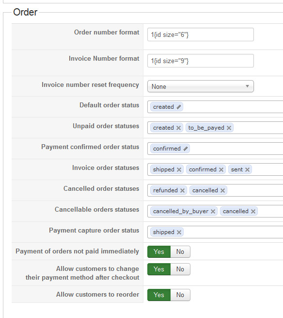

I've set Numbering format in HS according to our legislation rule (and as I know not only ours).
It says that Invoice number should be formated as consecutive numbers without gaps.
When shop sells everithing is OK and our (looking in HS->Orders) Invoice format is correct ... until vendor sells something and p.1 happens.

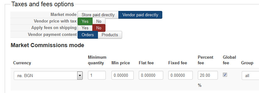

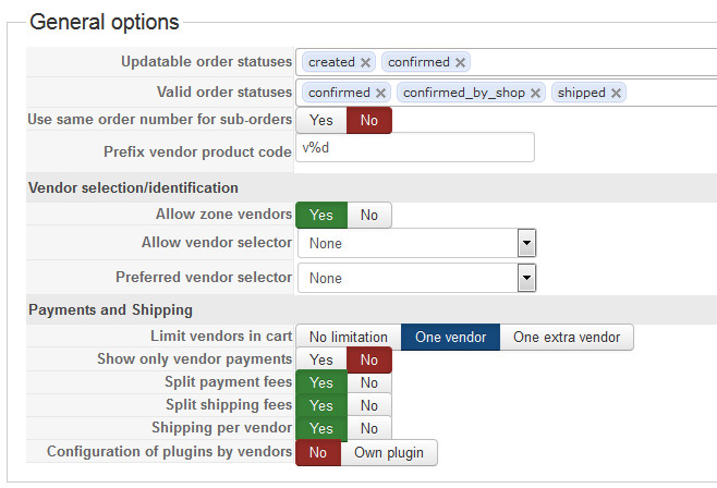

I've put some configuration screenshots also.

Vendor invoice number format
There is an issue for that specific point : the format.
If you take a look at the view "backend | vendormarket | options" you will see that the part for the invoice number format will set the value " {automatic_code} " if the setting is empty.
That is a mistake because each time that you will save a vendor in the backend, he will use the automatic format for the invoice and it won't use your HikaShop default configuration.
You can remove the two lines in the view and then empty that setting for your vendors.
And that issue will be fix in the next release.
Otherwise, HikaMarket respect the consecutive number without gap ; because the generated invoice id (and so, number) are consecutive value for each vendor.
That's why the "main order" is related to the shop (and customer) and why the "sub orders" are only related to vendors.
The first invoice that the vendor will create will be the invoice " 1 " because it is really his first invoice in that store.
The order number have the same logic but there is a setting to use the same main order number in the sub orders.
That setting exist to help the communication between the store, the customers and the vendor.

If you want the money be directly transferred from the customer to the vendor ; you have to use a payment method which do that.
Because the payment method (plugin) will be the element which will transfert the money to the final destination.
You can tell HikaMarket that your vendor are paid directly (so it will calculate the fee/commission), but if you're using a payment method which transfert the money directly into your bank account.. You will generate the issue.
That setting can't be magical ; that's why his original spelling was not that (but nobody understood it with correct accounting names...)
That is why you need :
1 - To limit your vendors in the cart ; so the transaction will be only between the customer and one single and unique vendor.
2.1 - To display only the vendor payment methods.
2.2 - OR to use "paypal adaptive" in "classical" mode so the plugin will use dynamically the vendor paypal email.
If you have several vendors in the cart ; The real life rule is that you can only pay one personne with one payment transaction.
Having X vendors to pay in the same time with one transaction, is not possible.
Like you cannot pay 2 people with one single coin. You'll give it to one of the two person and he will deal with the other one himself.

10 years 7 months ago #229007
That's great but unfortunately that's not possible in HikaShop.
HikaShop is creating consecutive numbers ; which means that it looks for the higher current number in order to get the next one.
So you cannot have "groups" in HikaShop.

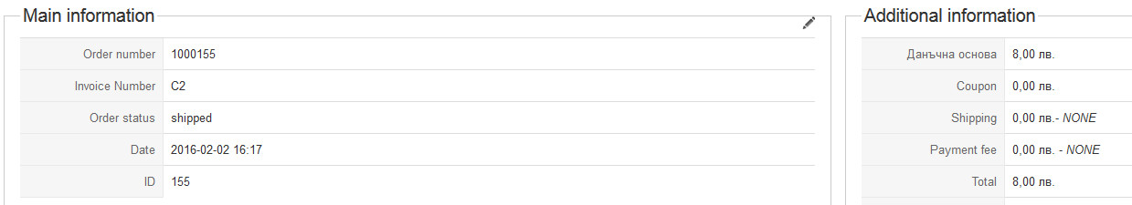

10 years 7 months ago #229083
Hi Jerome,
filiar wrote: First shortly what happens now when vendor sells is that three (3) Invoices are generated:
Ok, from the top
1. You fixed that
2. Ok (I never said it has not been)
3. This is when you press "Generate Invoice" for the vendor fee/commision. Invoice is being generated in HS. This is absolutely correct, because we charge vendor commission fee. The only thing is that the number here does not follow the consecutive rule.
In other words. How to set numbering format for Vendor fee invoices?
Regards!

Hi, Jerome.
Thank you for the detailed responce.
We really don't need you to redesign the process. It i just it should be exept the number format.
filiar wrote: Hi Jerome,
We would like to change "C2" to 1000000001 format. As here vendor pays us and the invoice number should follow our numbering rules.
What numbering rule does now the commission invoice follow (where from this C2 comes) and where are the number format settings to change C2 to 1000000001?
Regards!

Hi, Jerome.
I really am starting to think there should be some problem in my explanations.
If there is such please tell me.
As I said I've set the format. I also applied screenshot of the settings!
filiar wrote: I've set Numbering format in HS according to our legislation rule (and as I know not only ours).
filiar wrote: I've put some configuration screenshots also.
There is a screenshot from the first post:
If customer buy something from the shop (not from vendor) the right Invoice number is generated!
filiar wrote: When shop sells everithing is OK and our (looking in HS->Orders) Invoice format is correct
When we generate commission invoice this format is broken.
filiar wrote: 2. Invoice from shop to vendor should take the next number according to rule format (again this rule). And now totaly different number is assigned (C2)
Shop - To - Vendor WRONG NUMBER
This screenshot is from HS. This is the invoice that we give vendor about the commission. The invoice should follow our format because we are the biller and vendor is the recipient. But that format is broken.
If I don't explain something or if you need additional screenshots, or if you need acces, please tell me. Because there should be some reason that you can not get the issue.
Regards!
Last edit: 10 years 7 months ago by filiar.

1 - Market mode
2 - What you are doing
And then explain the issue.
Text in red or in bold does not help me much.
Explanation on the "why" could be useful sometimes but there is no need to concentrate on it.
To summarize your message in something I can understand in few seconds.
Market mode : vendors paid directly.
In the backend, we generate the vendor invoice for our commissions.
While HikaShop is configured with the invoice format " 1{id size="9"} ", the invoice number of that invoice is " C2 ".
And I already made some patchs for next HikaMarket release and one of them might be related to your question.
In the HikaMarket order class ; you can replace
if($vendor_id > 0) {
	if(!empty($order->order_status) && empty($order->order_invoice_id) && empty($order->old->order_invoice_id)) {
By
if($vendor_id > 0 && $order_type == 'subsale') {
to avoid the fact HikaMarket can interact with the invoice number on other type of orders.
