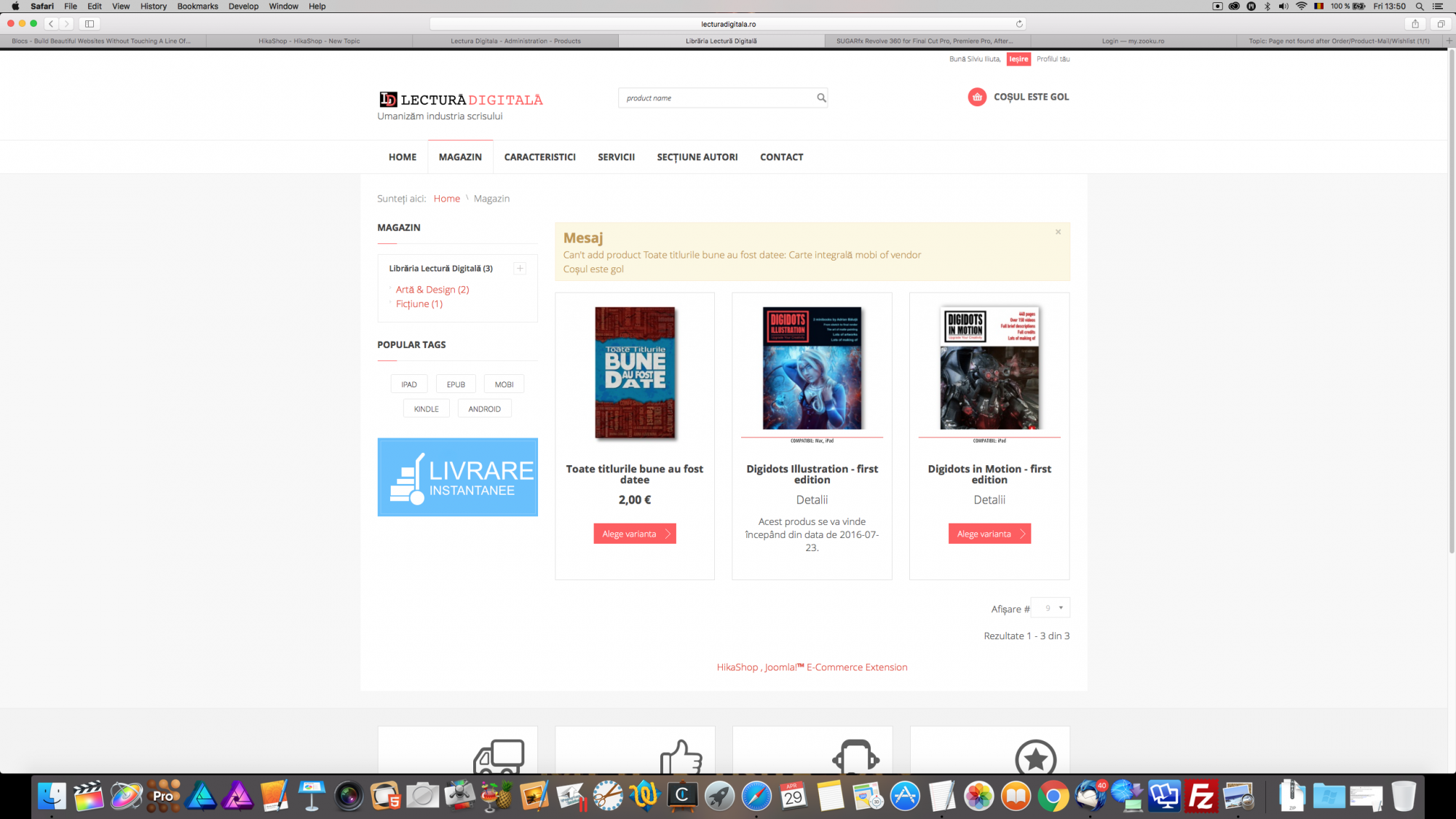

After I added a vendor on products custom fields, when i want to ad to cart the vendor product it gives me following error:
Can't add product Toate titlurile bune au fost datee: Carte integrală mobi of vendor
Cart is empty.
How can I solve this issue?

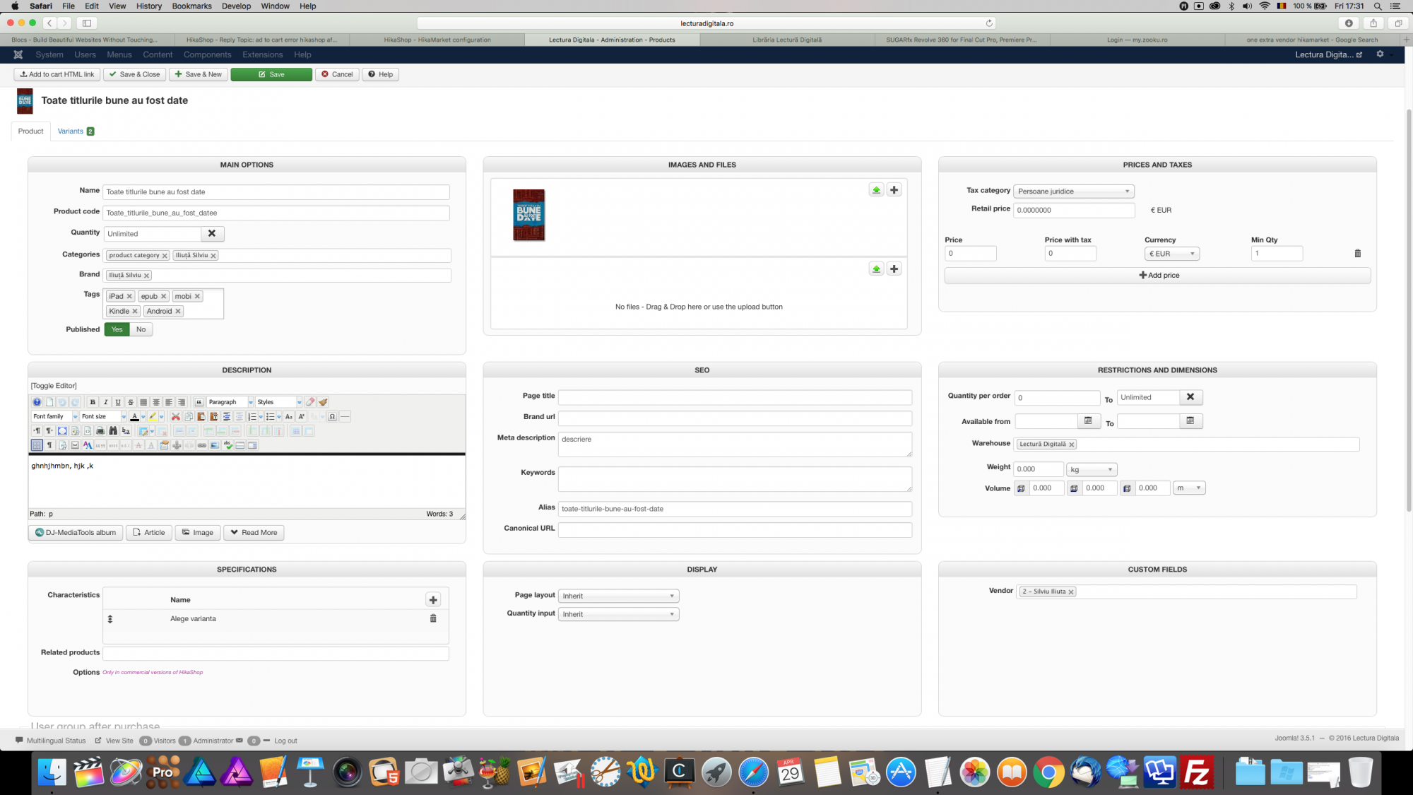

You have a setting which limit the number of vendors in the cart.

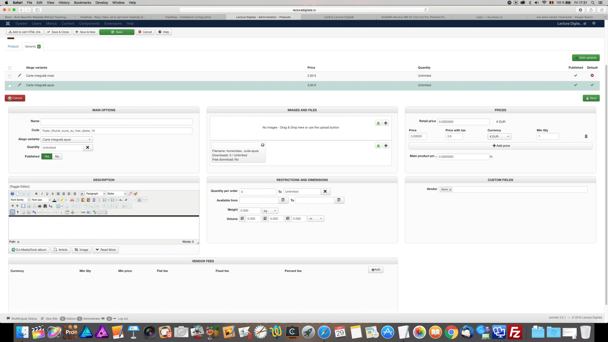

When you look at the product with the vendor account, it is just one product but in the shop we can see that the product have variants.
So we need to know how the product is configured in the backend ; what are the vendor assignation.
Maybe there is something to change in the configuration or maybe a patch would be required.
But currently, we have to retrieve more details about your current settings.

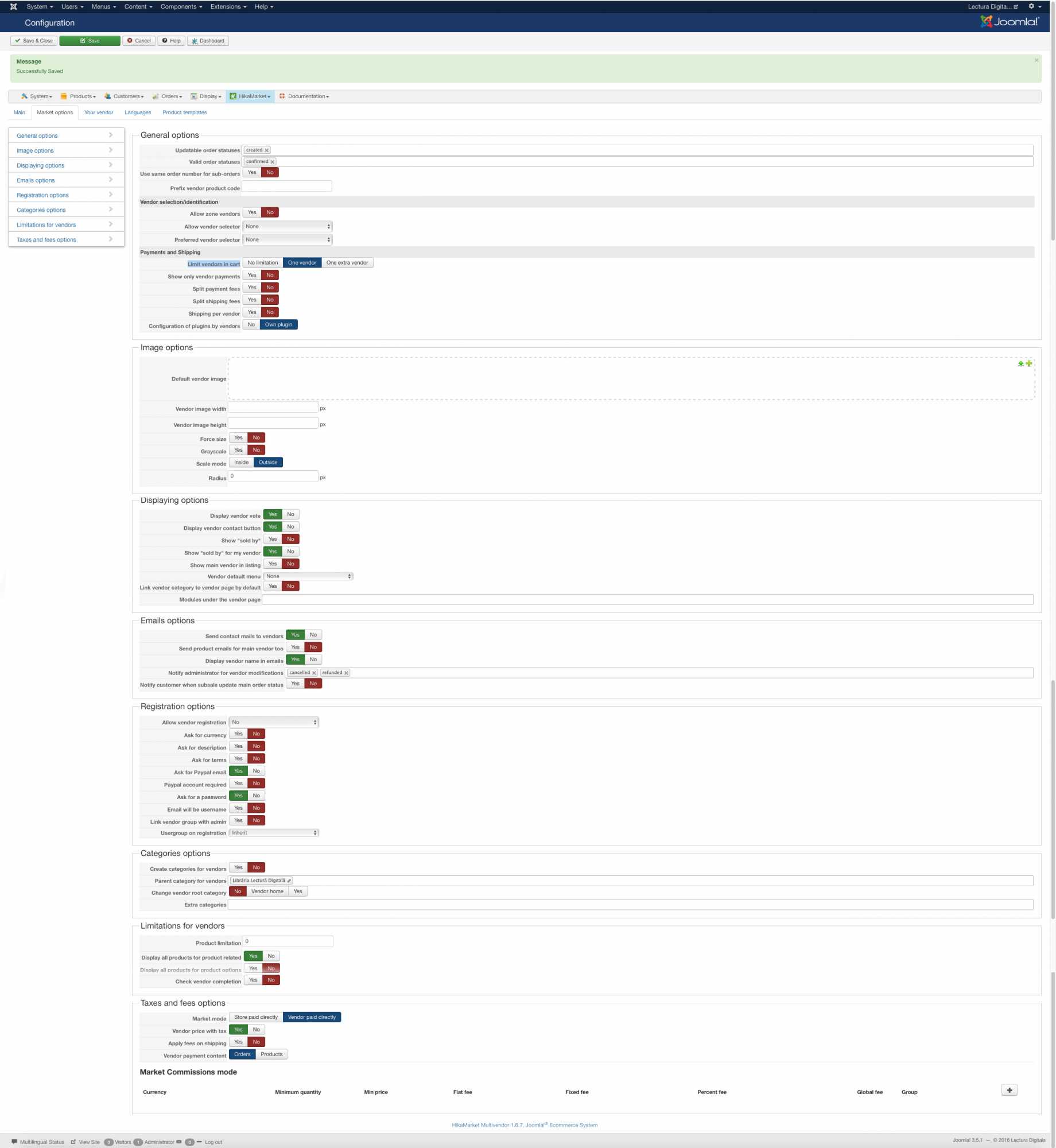

If I want to pay vendors directly in their account can I leave Payments and Shipping / Limit vendors in cart/ to NO LIMITATION?
One vendor in cart setting it is for the split payment process? If I leave to NO LIMITATION in cart the error disappear. But, I attached you my settings to see, maybe a patch is required.

I have an identical configuration than yours and I cannot reproduce the issue ; which is strange.
In order to be sure, I wrote a patch which should avoid the problem for what I suspect.
In the file "administrator/components/com_hikamarket/classes/cart.php" please replace
if(!empty($cartContent)) {
	foreach($cartContent as $p) {
		$v = (int)$p->product_vendor_id;
By
		if((int)$p->cart_product_quantity == 0)
			continue;
		if($v == 0 && $p->product_type == 'variant' && isset($cartContent[ (int)$p->cart_product_parent_id ])) {
			$v = (int)$cartContent[ (int)$p->cart_product_parent_id ]->product_vendor_id;
And please confirm me if it fixs the issue so I could include that patch in HikaMarket 1.7.0 (because the automatic update is launched).
