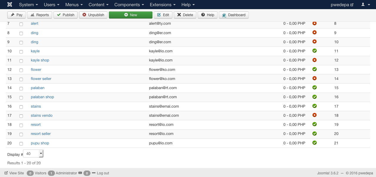

when ever i used the automatic validation setting of hikamarket two vendors appear in the back end
screenshot below

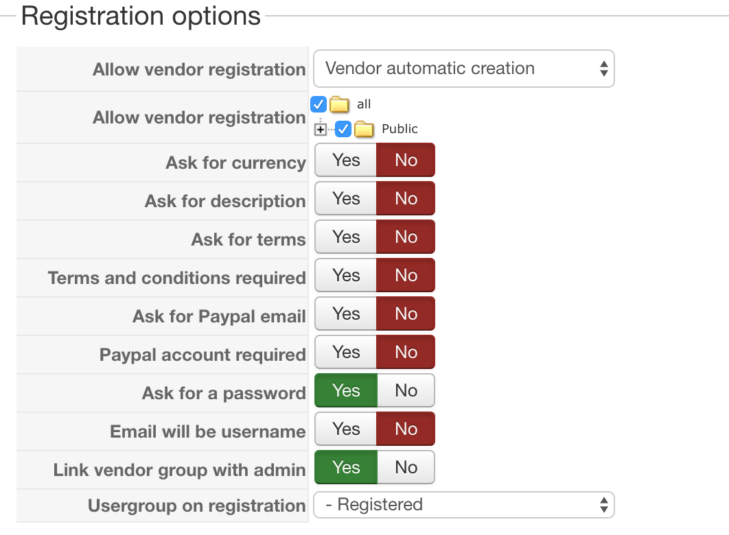

this is my settings

The vendor creation can be made under two conditions :
1 - A user is created and you have the automatic creation activated.
2 - A user (who is not link with a vendor) is updated and his update unlock the creation of the vendor
Would it be possible to have more details about how these vendor accounts has been created and have full details about two vendors sharing the "same" name ?
Please understand that "blank page" is a really vague description and it can be a lot of things.
So please provide more precise details about what is really that "blank page".
The fact that the vendor edition is forbidden means that you did not configure the HikaMarket ACL to authorize the vendor edition.

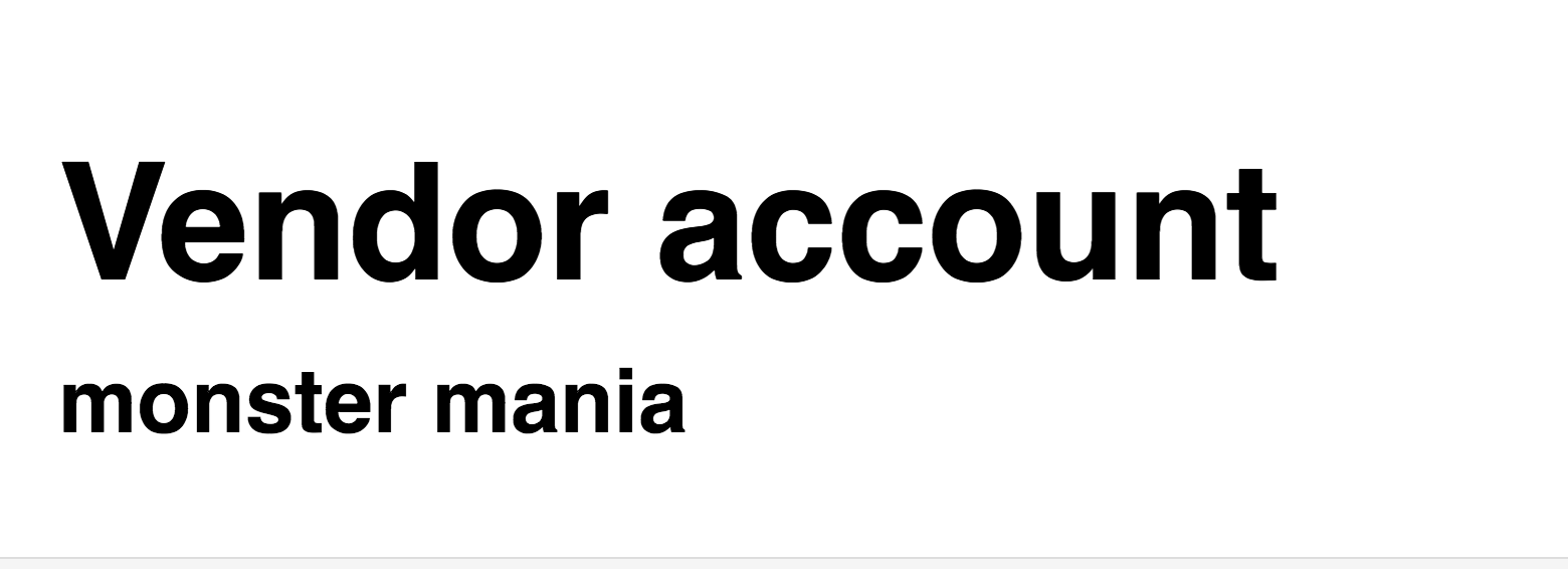

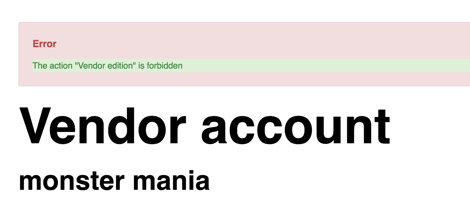

  • Posts: 490
9 years 10 months ago #253920
thank you
i created a link using vendor edition. When i click on this on the front end the "vendor registration page appears".
I fill up the form and register. I activate the user and login.
When i login i only see a blank page, what i mean about the blank page is this
When i click on vendor edition link i get this error
i checked the backend and found 2 vendors created for one registration.
i hope it is a bit clearer than before
thanks again
  • Posts: 26384
9 years 10 months ago #253922
Please provide elements for all of my questions :
About the second issue, as already explained :
And the empty vendor dashboard means that your vendor do not have any single available ACL ; so he can't access to anything.

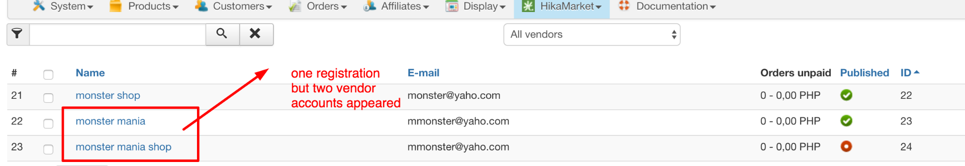

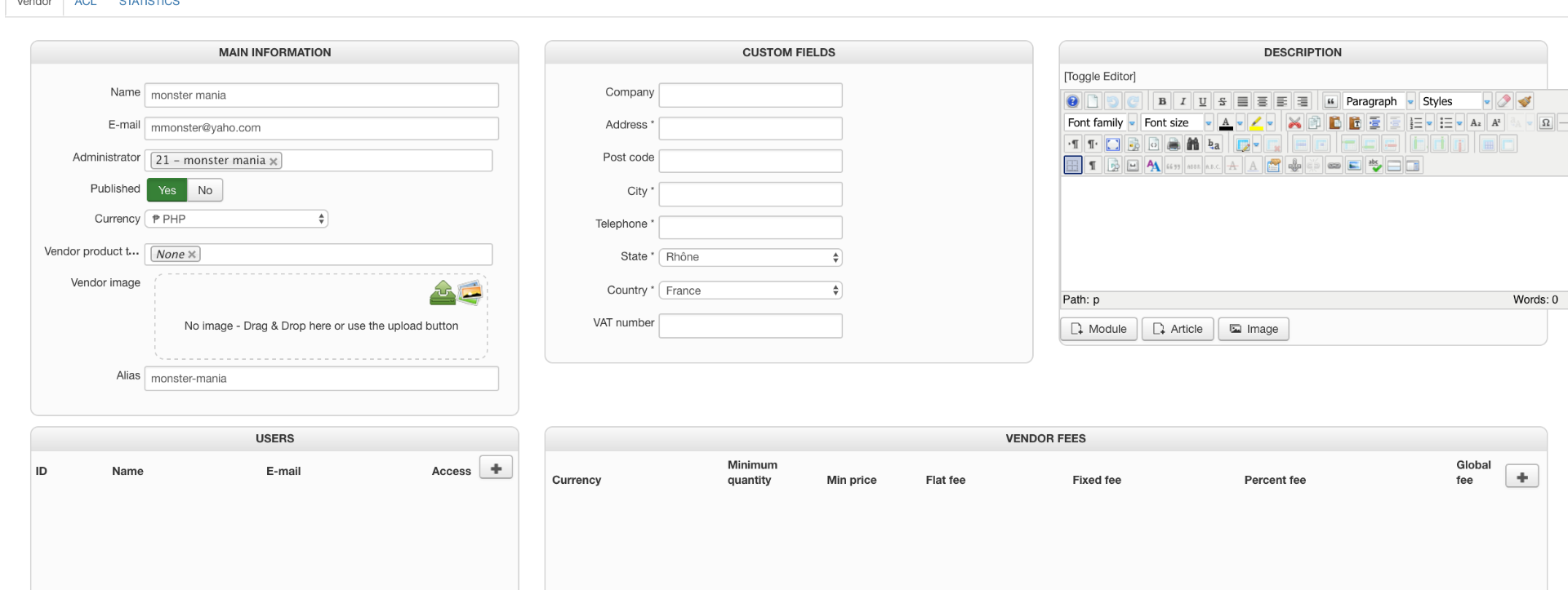

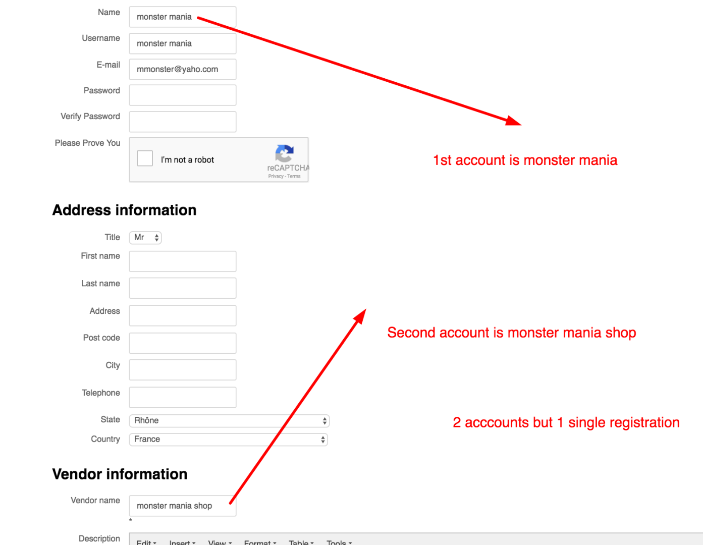

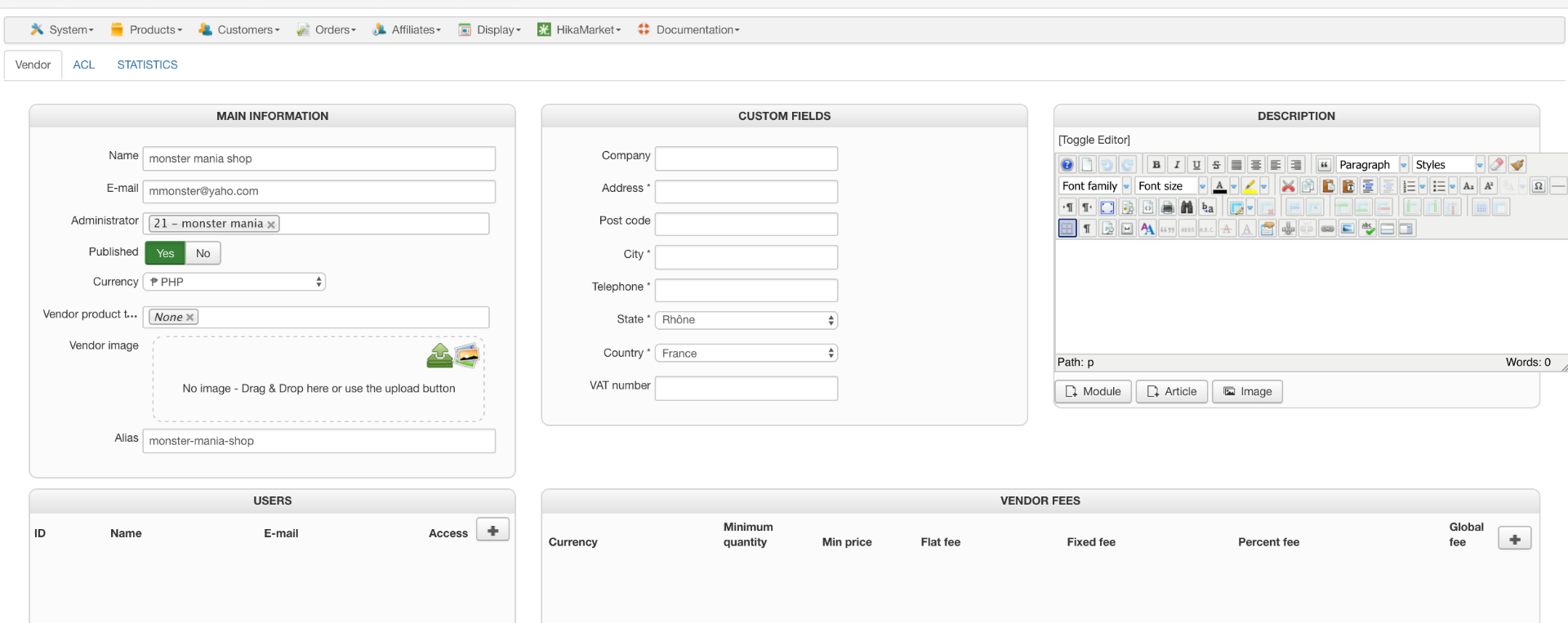

  • Posts: 490
9 years 10 months ago #254056
hi this are the two accounts that were created upon registraion
one is monter mania
and the other is monter mania shop
it was created by registering using the vendor edition link
it was created using 1 registration. Based on my observation vendor registration and vendor information was split into 2 accounts.
thanks
Last edit: 9 years 10 months ago by ronron.
  • Posts: 26384
9 years 10 months ago #254061
Okay ; I see the problem.
You are using the vendor registration while you're having the automatic creation.
The two elements are opposite.
You should use the HikaShop user registration the Joomla registration ; not the HikaMarket one.
