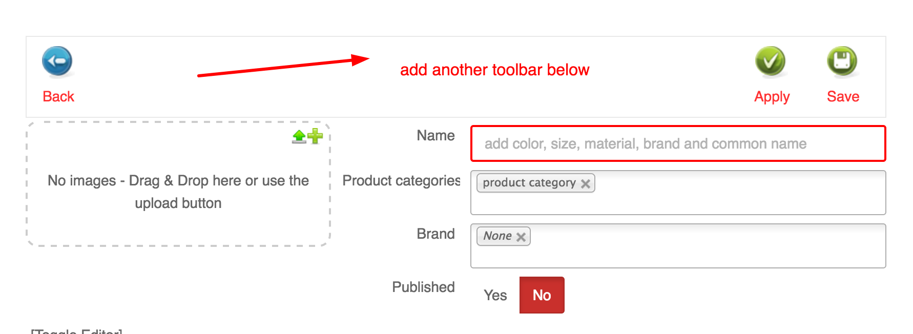

hi
how do i add another tool bar below HikaMarket - productmarket / form.php
thanks

If you want to add item in the current toolbar, you need to use a custom plugin or an override of the HikaMarket toolbar (view: toolbar / default).
Please note that the toolbar view is used almost everywhere in the front-end so you'll need to perform some context checks to add you elements just in the targeted page.
If you want to add a second toolbar in the view, you just need to put it at the beginning of "productmarket / form".

hi
thanks
i just want to add a second toolbar below. This will prevent users from scrolling all the way up.
Can you tell me what the exact code to add to HikaMarket - productmarket / form.php.
i tried to add this below so i would have a toolbar above and below the form but i get an error

If you just want to duplicate the toolbar, the best would be to just include the view :
$toolbarHelper = hikamarket::get('helper.toolbar');
$toolbarHelper->process($this->toolbar);
