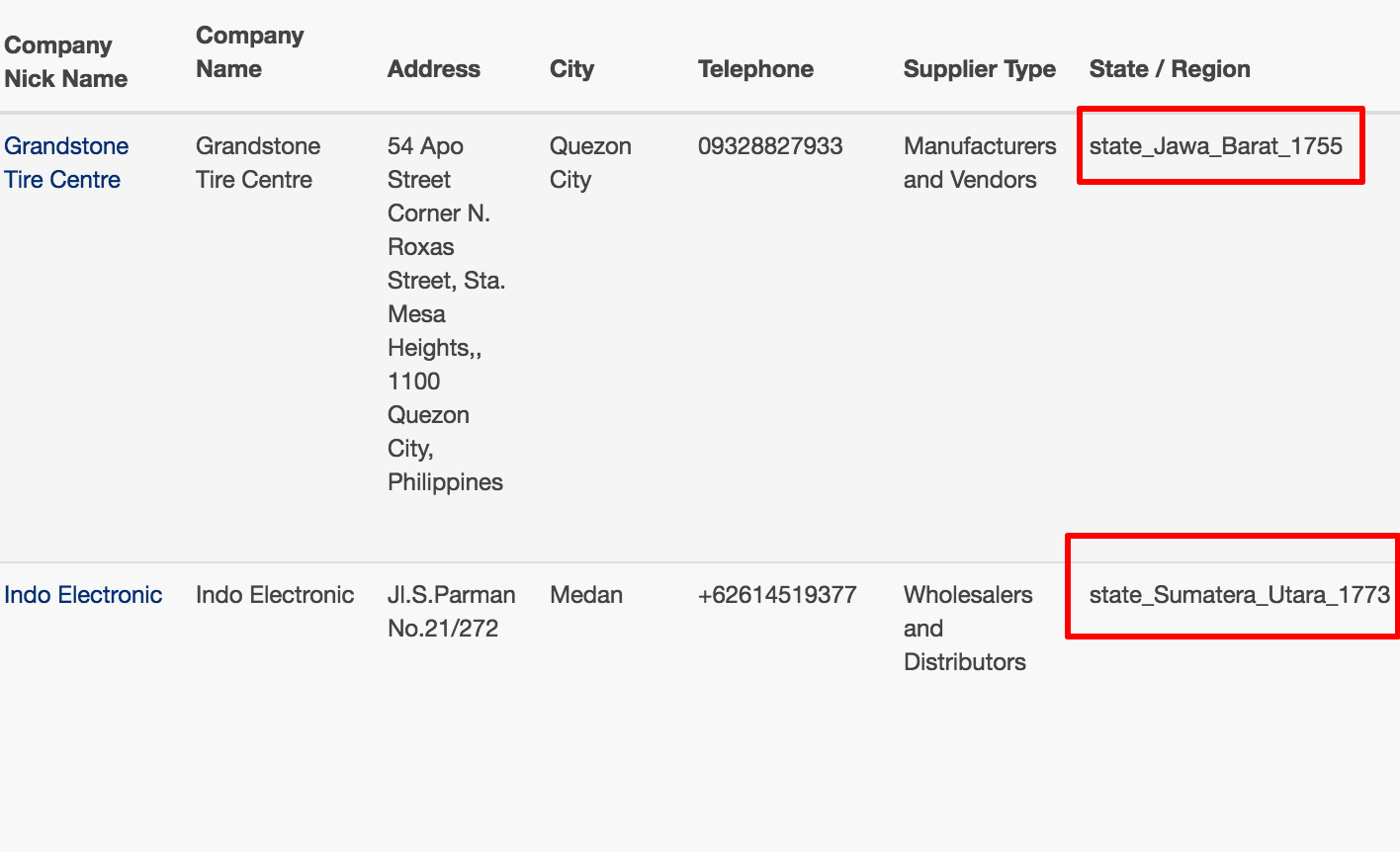

hi
for the vendors listing, the state is displayed with Id and other details.
this is what i see state_Sumatera_Utara_1773.
how do we remove the unnecessary details thanks?

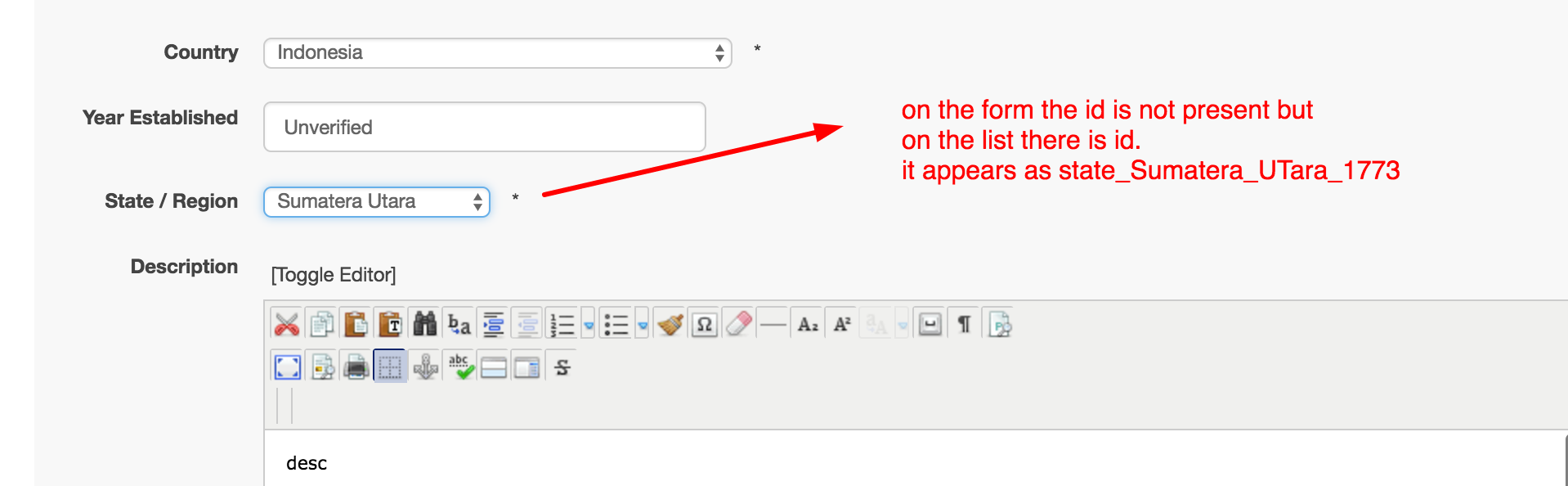

  • Posts: 490
9 years 9 months ago #256575
hi jerome
please see the screen shot.
the state has the id on it
the correct one should say
JAwa Barat and Sumatera Utara.
these are states in indonesia
you can also see the form which displays the correct one.
howt to correct this?
