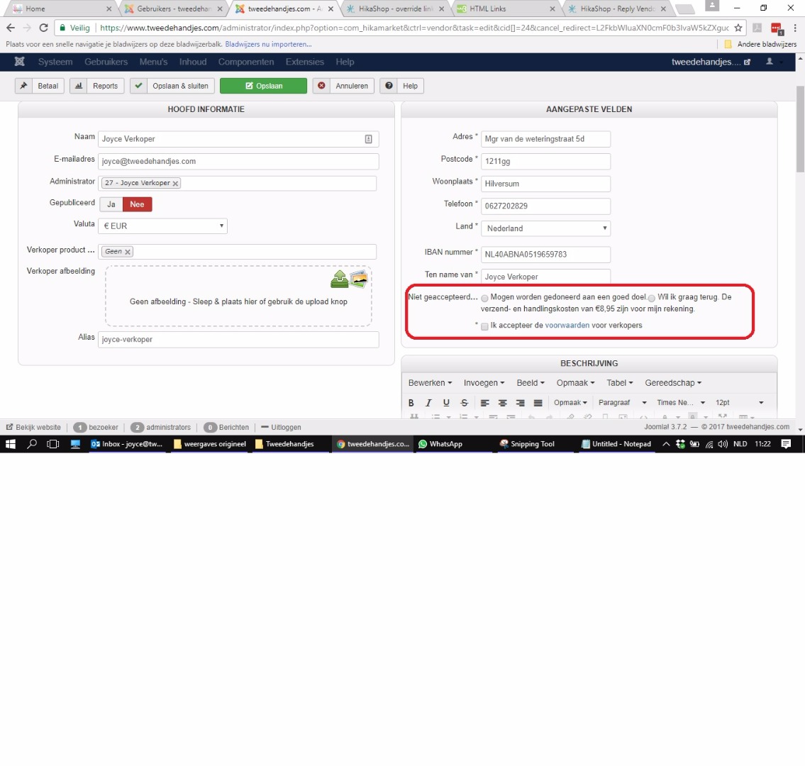

Hi Jerome,
Indeed, the setup was "automatic" and is now set to manual, which is better actually.
Still I have the "missing information" issue. Please see attached a new file saved as .JPG
As you can see, the information with the red border did not flow to the backend.
As the field are mandatory, I'm 100% sure I have completed them.
Can you see what is the issue?
Hikamarket version is 1.7.3
regards,
Joyce

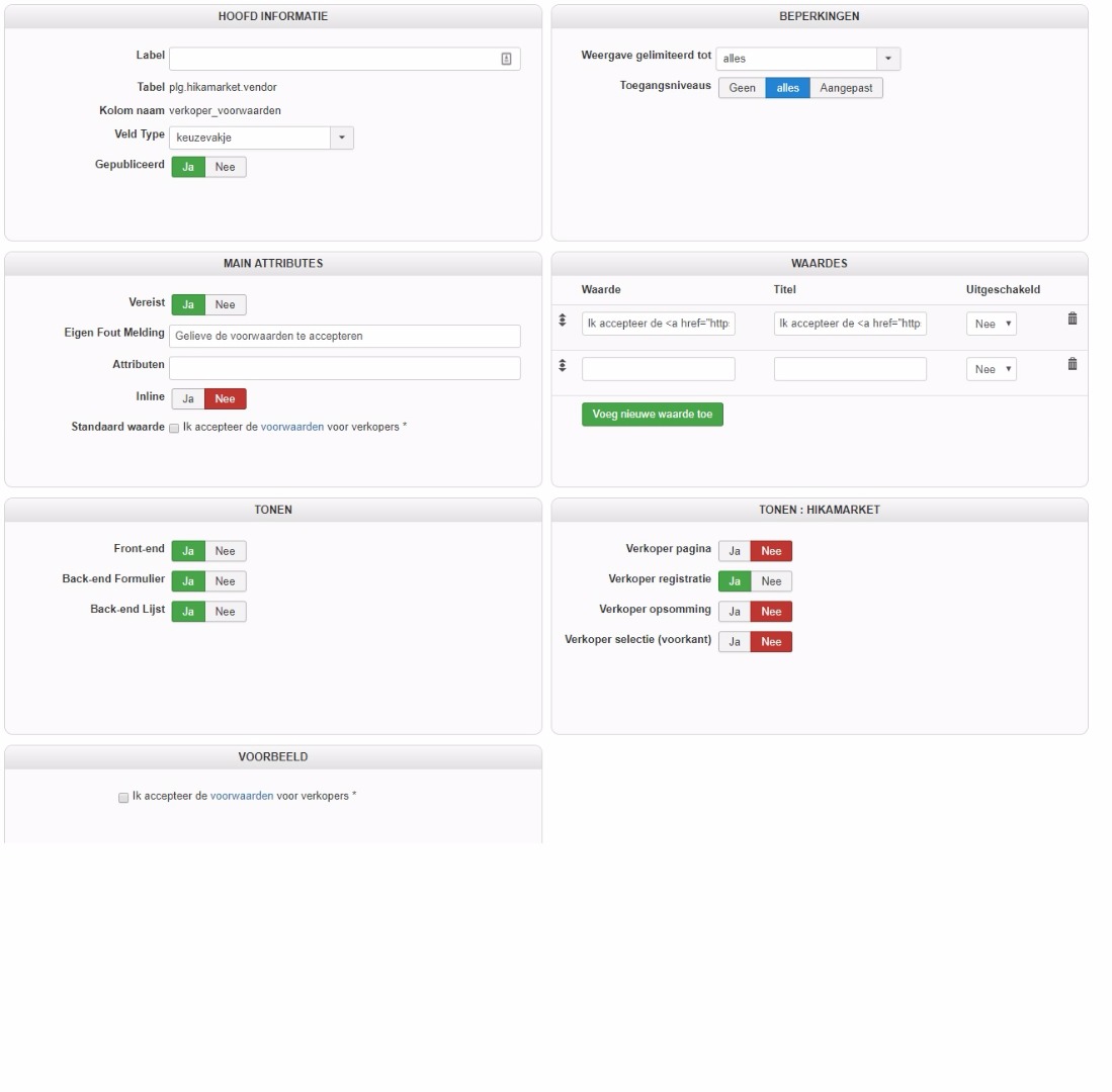

  • Posts: 115
9 years 3 months ago #271293
Hi Jerome,
This issue affects the new registration, so the manual one.
Please see attached the configuration of the custom fields involved.

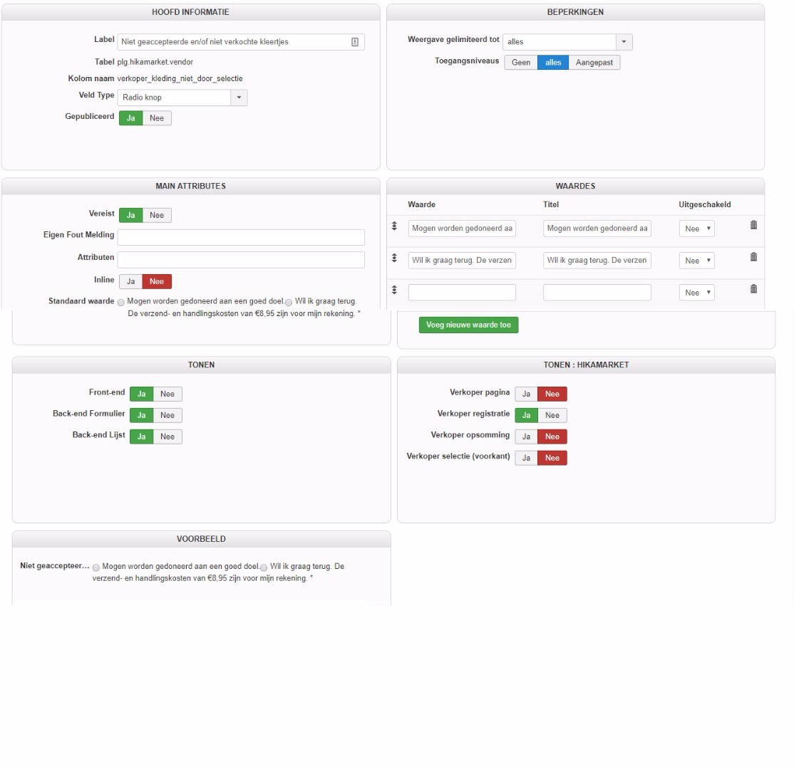

  • Posts: 26384
9 years 3 months ago #271295
When you create/configure a custom field ; please provide a content which will be a "value" for the "value" part of the field.
You're free to enter what you want for the title ; but for the value it's best to use short content, namekeys.. Or numbers !
But using content with double quotes and HTML as "value" ; I'm afraid that's not a really good solution.
