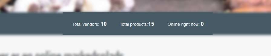

I would like to add a Hikamarket statistics modul on my frontpage that shows: Total vendors, Total products, Total Orders.
Something like what you see in back-end of Hikamarket Dashboard, with "Numbers of vendors" and "Orders unpaid".
Is there a module/plugin for that?
If not. I will try to develop one.
Henrik

  • Posts: 136
  • Thank you received: 7
8 years 5 months ago #289674
You're talking about the statistics blocks which are displayed in the front-end vendor dashboard ?
Yes, and no.
Yes, it is some of the data shown to a vendor in his Dashboard. But no, not for his data only, but for all shop/market.
I'm already doing a custom module that builds on module \administrator\moduels\mod_status\ to get "Online right now" on my site.
And then I found SQL in \administrator\components\com_hikamarket\classes\statistics.php on how to get "Total vendors".
And then I looked at databse to get SQL for "Total products".
And then putting it together in a module called \mod_hikamarket_stats.
Already working :-)
Would it be OK to share here?
It is not something I will support, but maybe others can use it and build on it or maybe you could consider making it at Hikamarket Module?
Best regards,
Henrik

  • Posts: 136
8 years 5 months ago #289793
Hi Jerome
I'm not a developer and don't want to support it. And it is not that I need to get credit for doing this module. If you would like, you can use it and maybe make it a standard part of Hikamarket modules? Feel free to change all code and make it better.
It is working the way I would like in my site. I will soon go online with my site that I have been building on for years! :-)
Anyways.. I have attached the module and you can view it on my site.
Best regards,
Henrik

  • Posts: 26384
8 years 5 months ago #289805
See : github.com/HikaShop/mod_hikamarket_storestats
I just cleaned a bit some PHP files (to remove the HikaMarket parts in the header) and I also change the way that the queries are made to use the Joomla 3 query system.
  • Posts: 136
8 years 5 months ago #289856
Hi Jerome
Thank you for cleaning up the code and putting it on Github ;)
I have added "Total shipped orders" to the module. Fixed a bug in how to get module suffix. Added CSS for mobile device. And added option to set Show/Hide on the different statistics in the module, so that you can decide what to show in frontend.
I committed it all local, but cannot push to repository. I'm kind of new to Github (I use Bitbucket). Should you invite me? And will you do so? Or should I just attach here again?
I'm 'quercusdk' on Github.
Best regards,
Henrik
