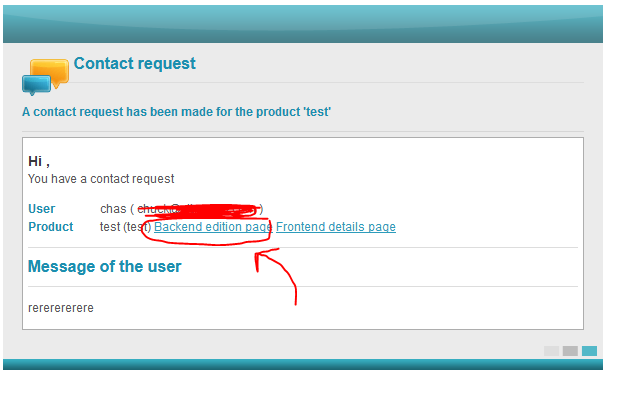

When a customer contacts the vendor through the vendor product page contact button, the email to the vendor shows a link to back end.
I would like them to only have a link to their front end admin or page not back end. How do I remove that link in the emails?

Indeed now Hikashop add the backend edition page in the "product contact email" ; that part is directly processed in the contact preload and HikaMarket do not have a direct/simple access to give another URL.
Right now you can see to make an override in the HikaShop contact preload to not add the backend link when the product is assigned to a vendor
if($data->product->product_vendor_id > 1) { /* ... */ }
In the mean time, I will work on a patch in HikaMarket to re-generate the all block when the email template is processed.
