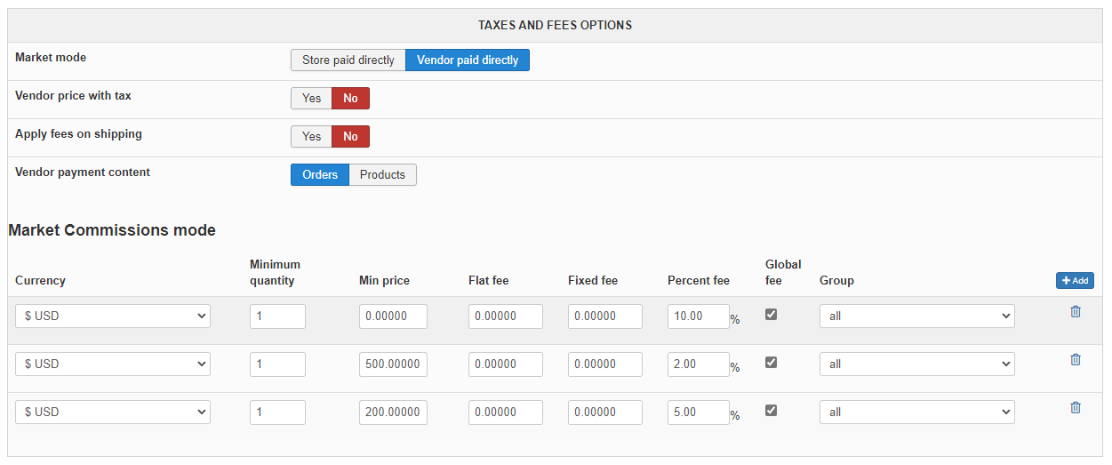

Here is our problem with "TAXES AND FEES OPTIONS"
Our settings...
If Global fee is unchecked, NO commissions are charged!
TEST 1 (Product price 300$) commission 5%
Our commission...
The commission here should be 15$
TEST 2 (Product price 600$) commission 2%
Our commission...
The commission here is correct
TEST 3 (Product price 30$) commission 10%
Our commission...
The commission here should be 3$
Please advise...
Thank you in advance!

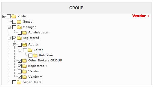

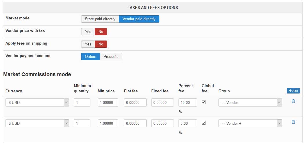

6 years 3 months ago #319096
Fees settings...
VENDOR ACL...
VENDOR + ACL...
Vendors from both Groups ("Vendor" and "Vendor+") are charged with 10% fee when the make a sale, when "Vendor" should be charged with 10% and "Vendor+" should be charged with 5%.
6 years 3 months ago #319137
The issue is related to the "Global fee" setting which was not handle in one place of the algorithm.
In the file "administrator/components/com_hikamarket/classes/fee.php" you need to replace
	$fee->fee_group = (int)$fee->fee_group;
	if($fee->fee_type != 'config')
By
	if($fee->fee_type != 'config' && $fee->fee_type != 'config_global')
And the vendor group filtering will be enable for a fee rule using "Global fee".
I will add that fix in HikaMarket and include a new unit-test for that case.

6 years 3 months ago #319204
You do have the patch in your website but I can't understand your test.
For the last two orders, I check the vendor configuration and saw that your vendor do have the two groups in the same time :
pasteboard.co/J8xD96Y.png
By having the two groups, the "best" rate will be used by HikaMarket.
The following user(s) said Thank You: liaskas
  • Posts: 205
  • Thank you received: 12
6 years 3 months ago #319216
Yes you are right!
Issue is resolved.
