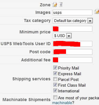

A friend of mine from USA has web site and she decided to use USPS as shipping method.
I installed this plugin and it works well when we add new user from USA.
However, when I setup new user as foreigner, say, from Australia, I got following error:
"USPS error: -2147218043 Unable to calculate international postage.
Failed to obtain shipping quotes."
Her account is moved with USPS to production server, we tested it on USA users and it works flawlessly.
In USPS shipping method configuration International service is checked.
Did I miss something in configuration?
Dragan
