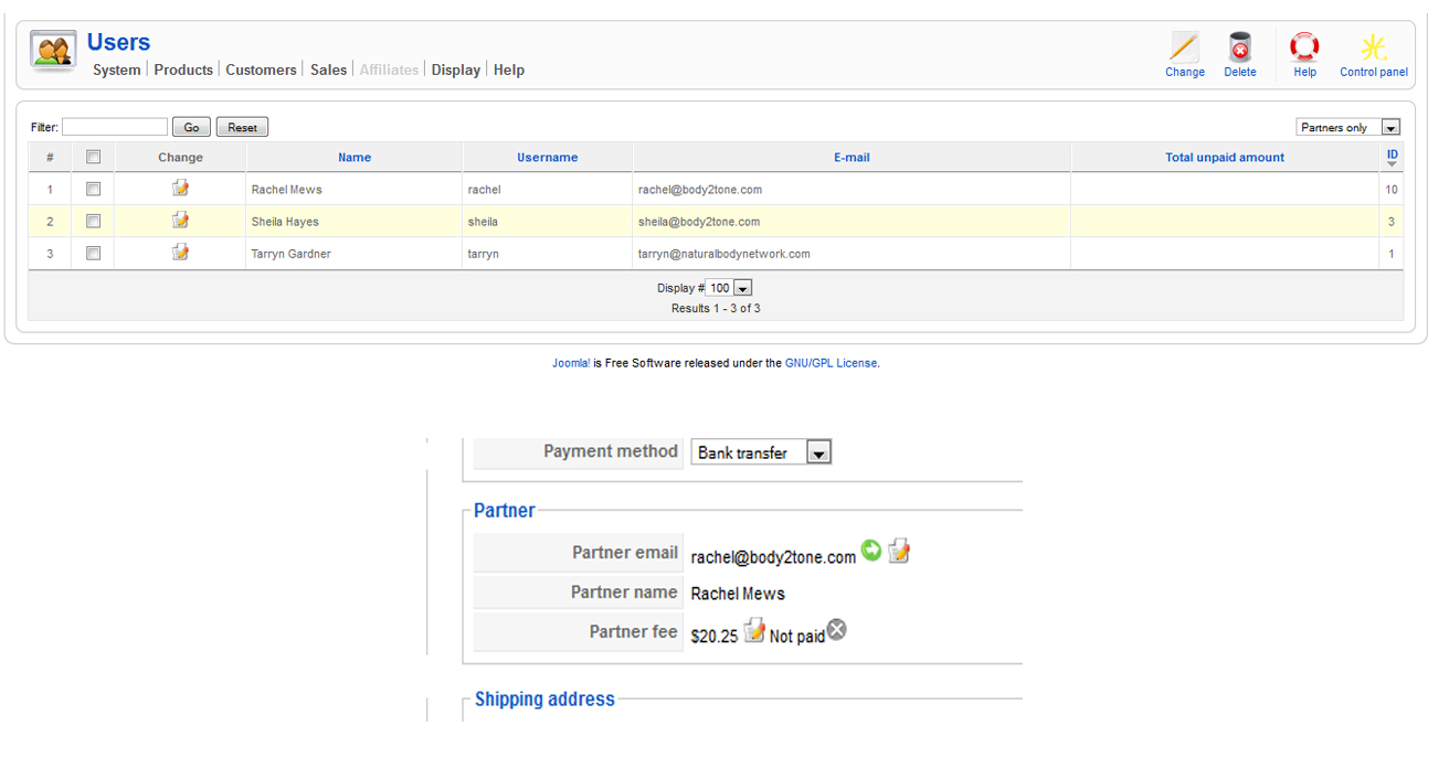

  • Posts: 13
15 years 1 month ago #21588
Hi Nicolas
please see the "total unpaid amount" in the screenshot attached. I am not sure why you mentioned the info is there??? sure if you drill down into the person you can see it - but it should be showing on the landing screen...

  • Posts: 86178
  • Thank you received: 14214
15 years 1 month ago #21599
I tried to access you back end again in order to look at the problem but I got an error:
500 - An error has occurred.
JDatabaseMySQL::query: 1146 - Table 'bodytuamkv_db1.jos_jcacl_block_list' doesn't exist SQL=SELECT * FROM jos_jcacl_block_list WHERE `option` = '' AND (user_id = 70)
It seems that JCACL database is missing but that you still have some part of it on your website. You should first disable the debug mode in the configuration.php of your website via FTP so that you will be able to restore the access to the back end and then make sure that the JCACL component is either properly installed or properly uninstalled.
Anyway, I see what you mean now. I was indeed talking about the information on the user edition screen, not the information on the listing. We'll have to look at that and fix it for next release.
