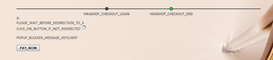

15 years 1 week ago #22896
Hi, Nicolas
I developed new credit card plugin payment (KeyClient).
I copied from epay (similar) modifying name in keyclient; after I modified the configuration (keyclient.xml) and all php (keyclient.php, keyclient_configuration.php, keyclient_end.php) as in administrator/components/com_hikashop/extensions than in plugins/hikashoppayment.
Well, when it must open KeyClient_window (in standardwindow.js that I copied and wrote in my directories) this happens ('SI' is a my alert: first instruction of keyclient_end.php, before opening KeyClient_window) and pay_now button doesn't work and the page is in loop
Suggestions?

  • Posts: 86049
  • Thank you received: 14177
15 years 1 week ago #22897
In the txt file your provided there was no mention of a javascript file.
Looking at the txt, you should be able to just redirect to the keyclient payment gateway at the end of the checkout with a normal HTML form a two lines of javascript submitting your form.
Could you give a link to your shop so that we can try and see what could be the problem ?

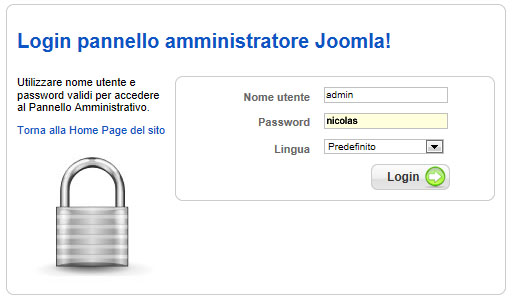

15 years 1 week ago #22906
www.inabox.it/gt
your backoffice credential:
  • Posts: 86049
15 years 1 week ago #22907
You have several problems:
First in your js file you have the line:
objForm.action = pageTracker._getLinkerUrl('<?php echo $vars["bankurl"].'?'.$vars["strECommerce"]?>');
and the line:
objPoll.src = '<?php echo $vars["bankurl"].'?'.$vars["strECommerce"]?>';
You're trying you have php executed in a js file. That's not possible.
Then, your form action URL is:
ecommerce.cim-italia.it/ecomm/Dispatcher...ZTQyMGE5ODk1ZmI%253D
As you can see you have several urls in there. That's not possible. You should urlencode all the parameters of that URL.
www.php.net/manual/en/function.urlencode.php
I see that you call open_KeyClient_window() when you click on the pay now button. Why not just submit the form like all the other payment plugins ?
