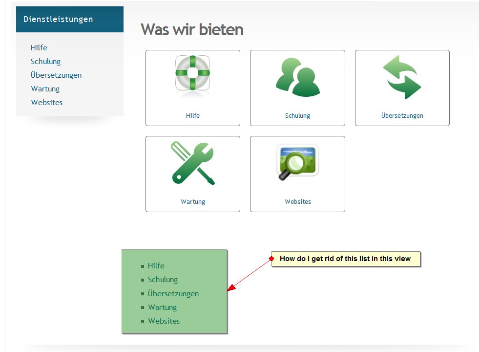

I have however found a different problem, relating to the modules. What I would like is a simple listing of categories in a side column.
I've activated (per language) a seperate HIKA Shop Content Module, which seems to be right one. It looks good when I'm at the top level of, eg the German page, but for some reason, under the category images, there is a list of the same categories, which I don't want there. See the attached image.

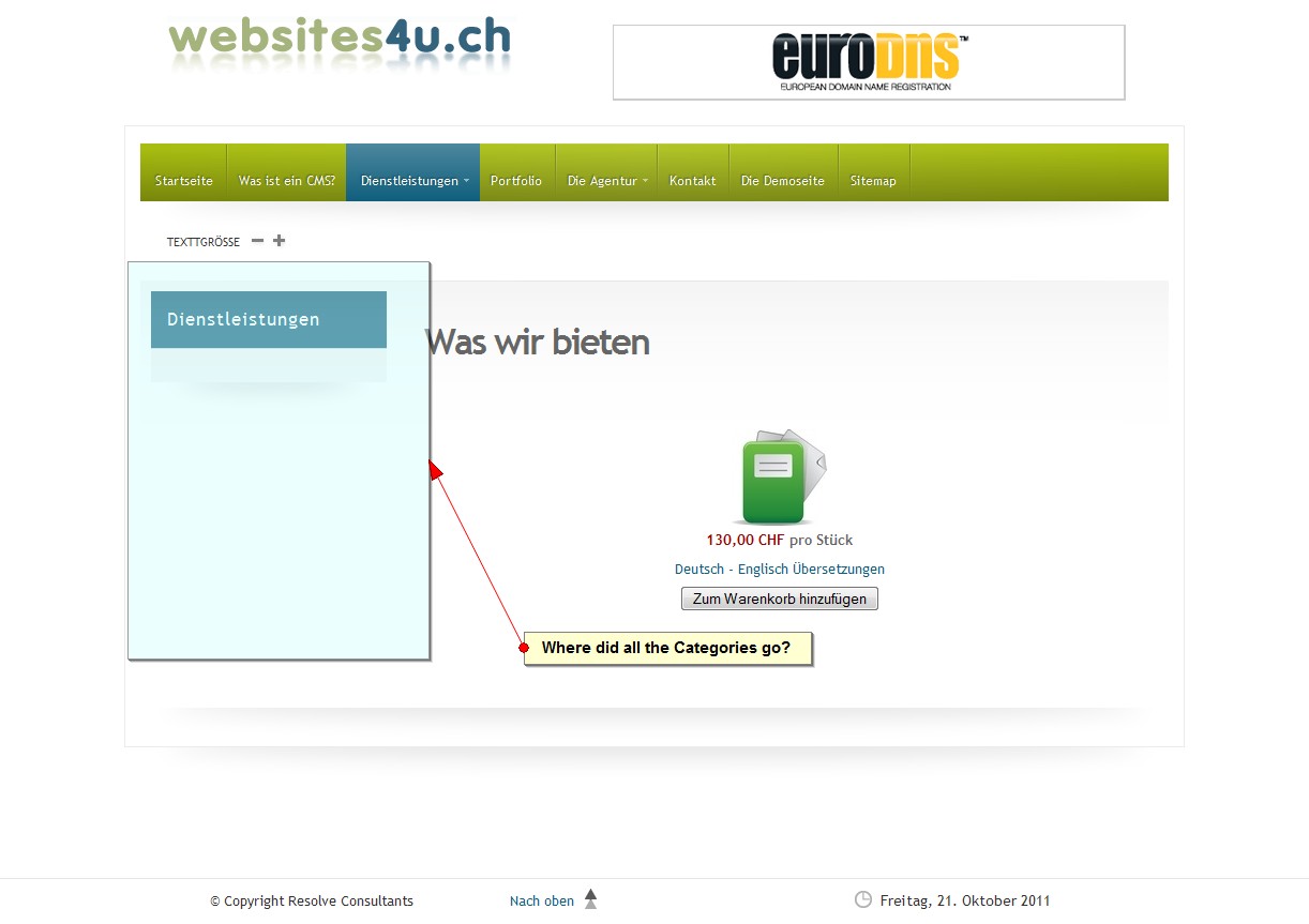

Also, when a category is selected, all the category list disappears in the module, which should, of course remain present as a navigation aid. See the image.
I certainly appreciate your rapid help - that's great.

Using completely the built in language system of joomla 1.6+ is not possible as it would be similar to duplicating the products (which you can already do). We would have to basically reimplement joomfish inside HikaShop to have the language system working properly. I don't see how we would be able to pull that off in the short term. That solution I proposed is already way more advanced on that end so I think that we'll just modify a bit the language handling in HikaShop to also support it. I can only see advantages to that option.
The display problem you're experiencing comes from the fact that :
1. In the hikashop options of your hikashop content module which displays your categories on the left, you have the option "synchronize content" which is turned on. That means that the content will change based on what is displayed on the main area. That's why you think that the categories left in your screenshot. It's just that there are no sub categories in the category currently selected.
2. In the hikashop options of the menu item that you're using to display the content in the main area, in the "associated modules" option, you have a module enabled which has its option "type of content" set to categories instead of products.
Normally, when you create a new hikashop content module to display categories, that should not happen as the system creates automatically a module with its type of content to products for the menu. So in any case, you can always look at our tutorial which explains step by step how to create a category listing module:
www.hikashop.com/en/support/documentatio...ml#categories_module
