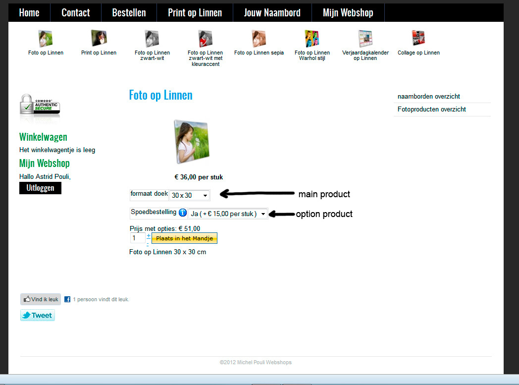

I'm using a discount on a product that has an option (1 day delivery). The discount is set for this particular product and the option is a product within a diferent category. However, the discount is given to 1 product, while the system acts like the option is a second product (2 products give 10% discount). How to avoid this?

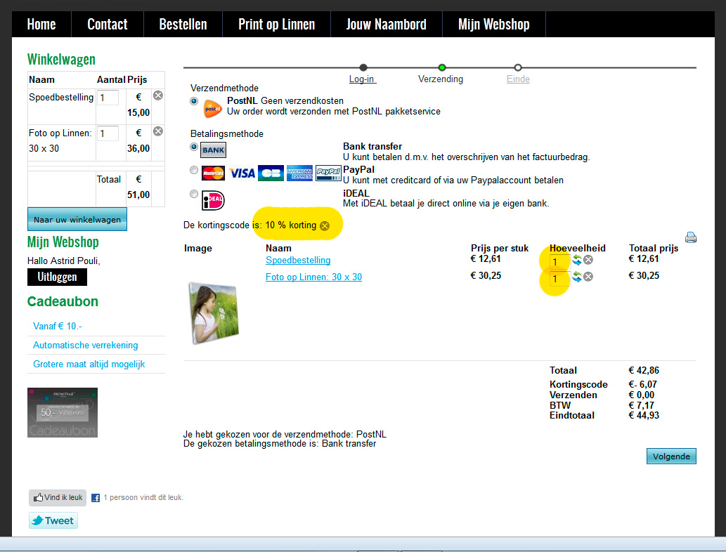

No there's no other code that overrules, but to be certain I disabled all the other codes. The problem still remains, it looks like it handles the option product the same as the main product allthough the option product has another category.

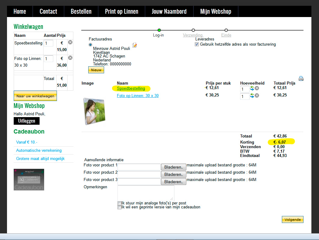

One thing I don't understand with your screenshots is that the total price before discount is 51€.
However, you get a discount which is over 10% of the total price, even including the option price.
So I don't see how that's possible.

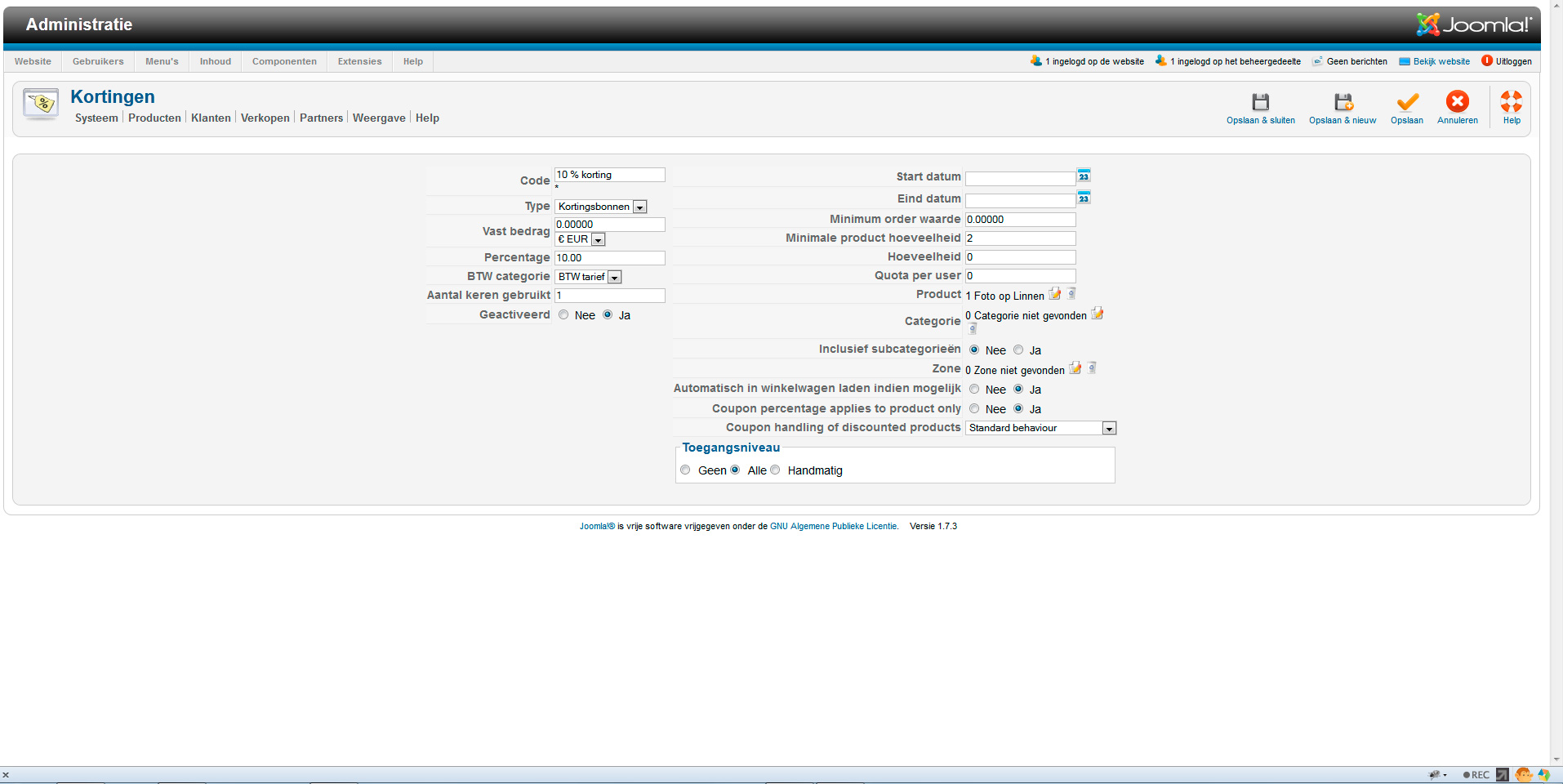

Your settings are indeed fine.
