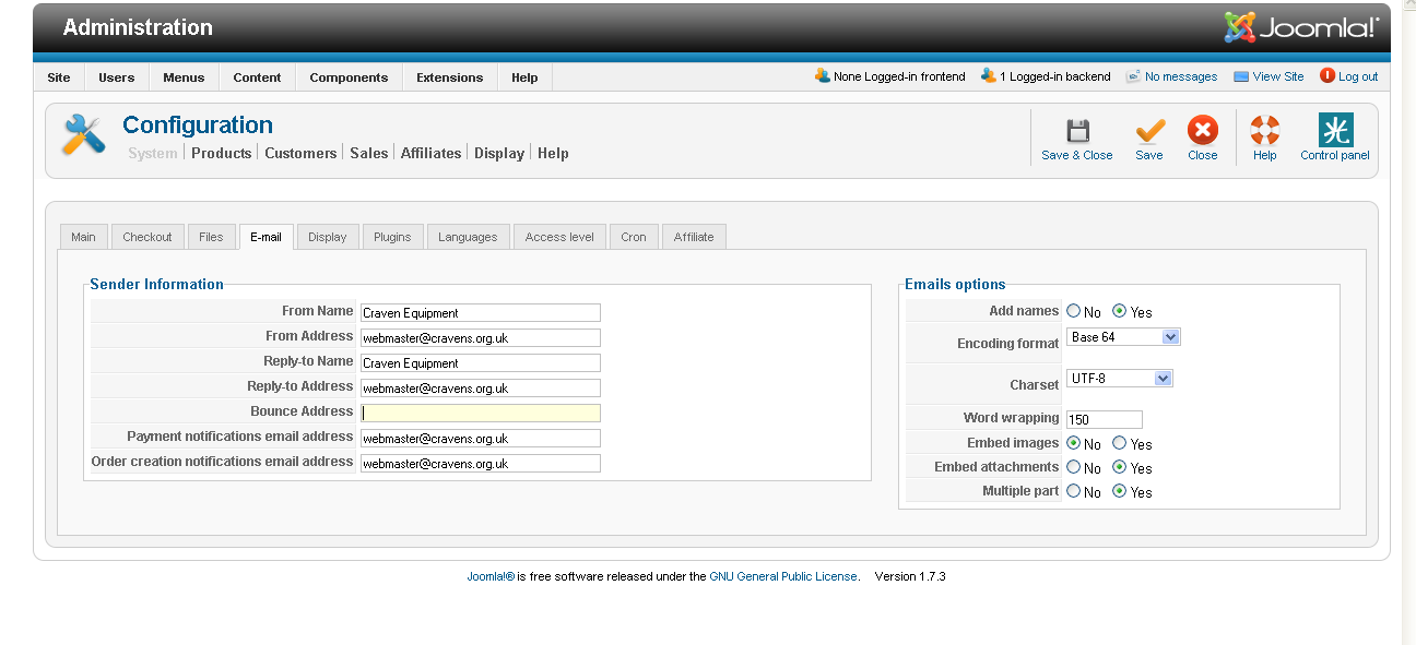

  • Posts: 234
  • Thank you received: 4
14 years 7 months ago #38421
Ahhh, I think it may have been the fact I had left the Bounce Address empty.
  • Posts: 86099
  • Thank you received: 14200
14 years 7 months ago #38557
Turn off the 'add names' option. If that still doesn't work, try to change the charset to the ISO charset of your language. If that still doesn't work, please send that screenshot to your hosting company and ask them why your emails are not sending with these settings.
