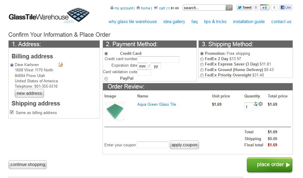

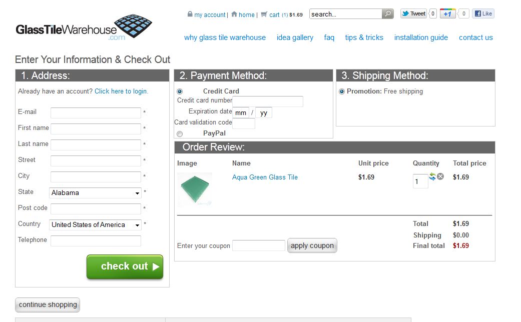

We are trying to create a one page checkout experience for a new site based on Hikashop ( www.glasstilewarehouse.com ) similar to what we have done with a custom one page Magento checkout in the past ( www.emergencyreserve.com )
The one page checkout we built with the magento site works absolutely great for conversion. It is a true one page checkout with everything entered on one screen and when the place order button is hit, the order is placed. No more multiple pages or extra clicks for the user.
We have been able to replicate this type of checkout process pretty close with Hikashop except for one problem:
When a new user enters their Address Credit card information (using Authorize.net payment method) on the 1st screen of the checkout they have to click a button to continue to a second screen to confirm their order.
This is fine to have a two page process, but the problem is that we lose the Credit Card information they entered on the first page, so the customer has to re-enter their credit card data.
This is very confusing to the customer and we are getting a lower conversion rate on our hikashop sites because of this.
Is there a way to make it so the Credit Card Information will stay in the form from the first page to the second page, so they don't have to enter their credit card info twice?
Or is there a way to make it so they just select their payment method on the first page and then only show the form for entering their credit card info on the 2nd page?
Ideally we could make a one page checkout like the one we made with Magento at emergencyreserve.com That one is perfect, but may not be possible to do with Hikashop.
That is ok as long as we can figure out a way to have as close to a one page checkout process as possible without making the customer have to enter their credit card information twice in the checkout process.
Please let me know your thoughts on what we can do here.
Thanks.
P.S. I have attached a couple screen shots of what our hikashop one page checkout looks like right now if you don't want to visit the site to see it live. As you can see in the screen shots the credit card form appears before and after the customer has entered their address, but if the customer enters their credit card info on the first screen, then that credit card info is lost in the form on the second screen and they have to enter it again.

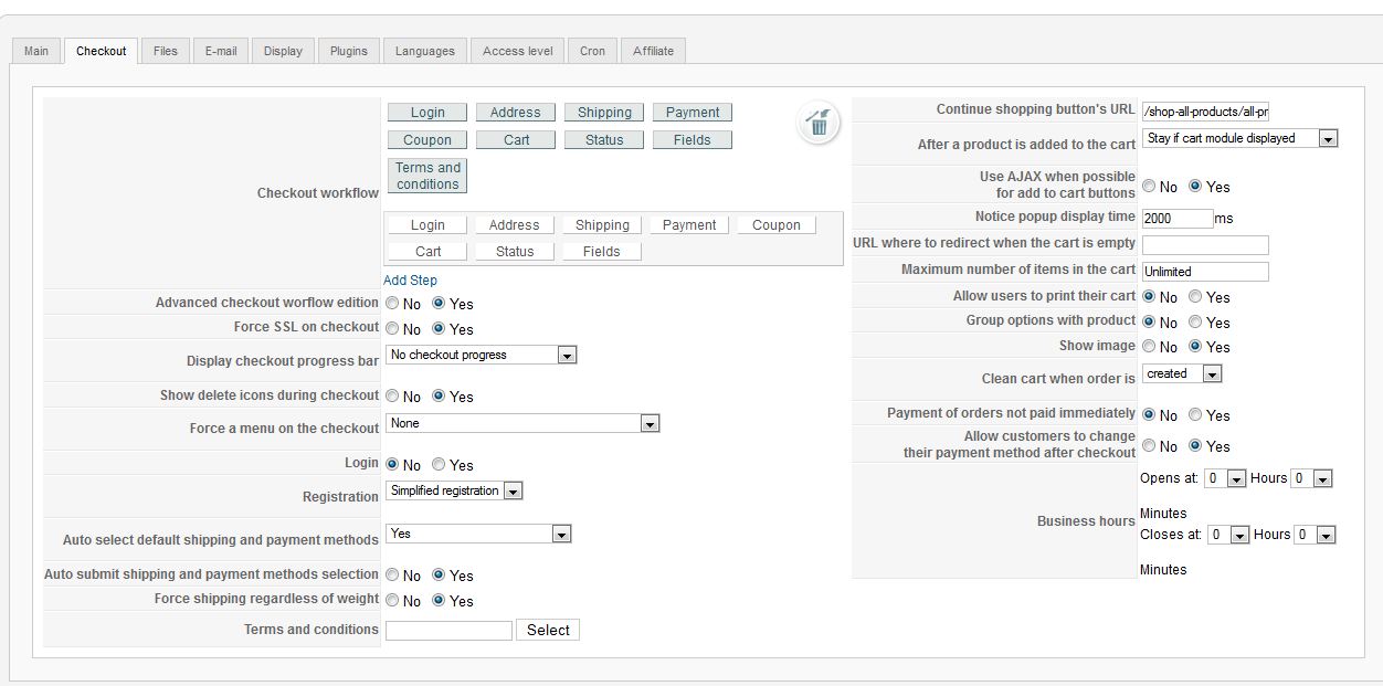

Could you also do a screenshot of your checkout tab in the configuration of HikaShop so that we can try to replicate the problem on our end ?
If I'm correct, the credit card information should normally be saved by HikaShop on the first step and displayed on the second. So you should not have this problem.

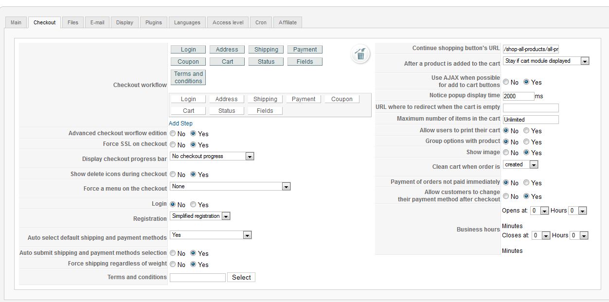

Thanks for taking a look at this issue, Nicholas.
I have attached a screenshot of our configuration at the checkout.
We are using the Authorize.net payment plugin.
The information entered in the credit card fields are not being sent to the next page in the checkout on any of the sites that we are running with hikashop so our new customers have to enter their credit card information a second time after it is lost when they fill out the address form.
Please let us know if you think this is a configuration issue or if it is something that needs to be fixed in the code.
