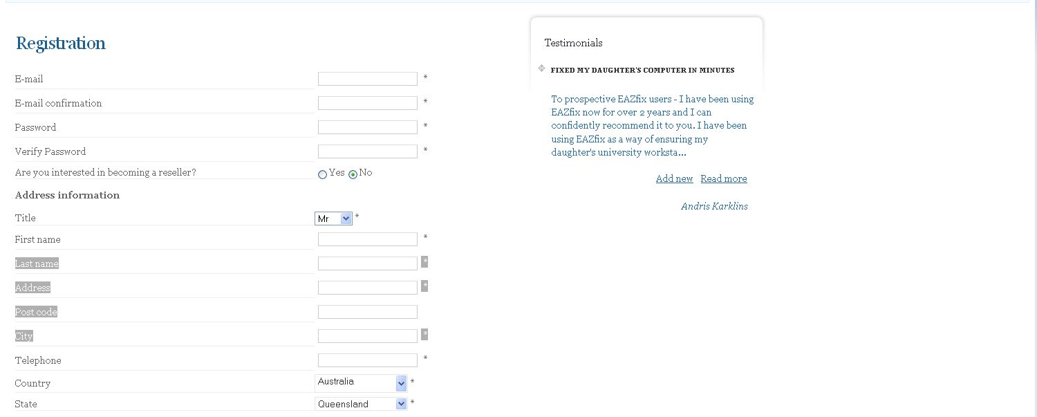

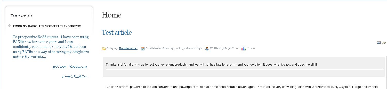

I have a couple of modules situated on the left. But when I use the hika registration form, it moves the modules to the right of the registration form.
Could you tell me if this is something I can change.
Patrick Thoi

I don't know. It can probably be fixed with some CSS in your template.
Can you give a link to that page so that we can look at the CSS on your website ?

The problem comes from your template.
On the other pages the main section has a class push_3 and the aside has a class pull_6 while the on the registration page, these classes are not there.
That part of the HTML is above HikaShop and handled by the template, so I would recommend you to contact your template provider for help.
