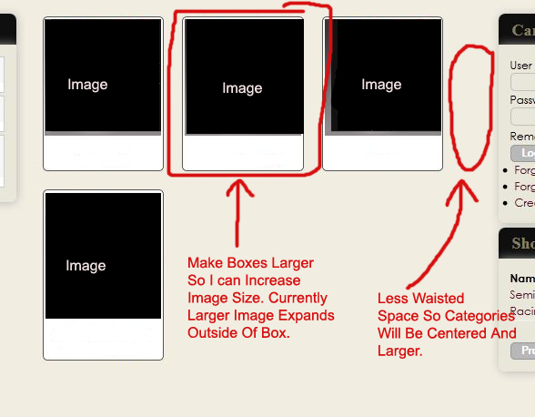

13 years 11 months ago #66441
I uploaded an image if you can take a look at it.
I am trying to make the category boxes larger, centered and be able to take up more space on the page rather than having as much waisted space.
  • Posts: 86087
  • Thank you received: 14194
13 years 11 months ago #66467
In the hikashop options of your listing, you can reduce the "margin" option so that there is less space between each product box.

13 years 11 months ago #66682
I tried this but it did not have an effect of moving the categories section boxes centered.
Also I am trying to figure out how to make the boxes larger so that I can increase the size of
category images in this section. If I make images larger than they go outside of the box.

13 years 11 months ago #66731
On this page you will notice that the images can be sized no problem but the box border does not fit the category image.
The categories are not centering on the page.
There is also too much waisted space around the image.
rhinobmx.com/index.php/catalog
Thank you.

I will mess with that more. However, what part will make the box larger or expand with the thumb image so that the image does not expand out of the box?
13 years 11 months ago #67244
Hi fan4chevy,
You can't edit the box width, but you can edit the image width to reduce it a little with this property:
.hikashop_category_image img{
    width: 120px !important;
Be careful, this property is for 3 columns, if you set 2 columns, the images will be to small.

13 years 11 months ago #67418
I really appreciate your help. When I did the additions it also moved the category list box as well ( the links located to the left). Also the borders around the image do not change. The most important thing I am trying to do is increase the border to fit larger images lets say 150 or 175. Where do you change the border?
