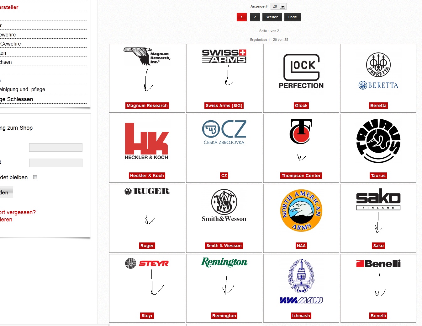

I have a view, that displays all brands and manufacturers. Some manufacturers has a logo that is not more like a square. Please find in the attached picture what i mean!

3) I think that it can be done by css editions.

3.) Okay, then I'll try to have a look at it

In additional about that "Zoom-Stuff": This idea is rubbish :) I just reduced the amount of products/categories per line from 4 to 3
Then there is more space and the pics can be done bigger (for a better view). Maybe I'll reduce it to 2 per line to make the pics even larger. And the centering of the pics is still open, but I'll manage that soon over the CSS or in the PHP-Code: Should be no problem B)
