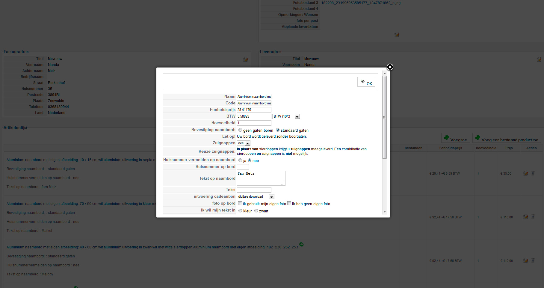

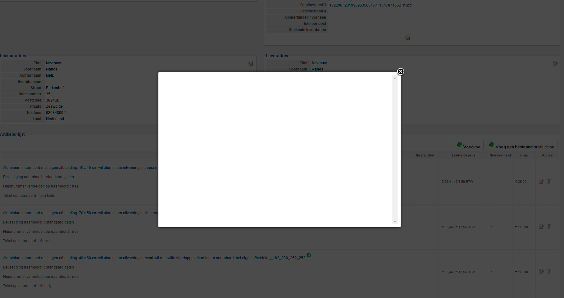

In version 1.6.0 V.20 I try to edit some productdetails in an existing order. In the editmode I make some changes and after hitting the OK button the popscreen turn empty and freezes. I tried to trash the changes I made to the "invoice" and "adress" templates in the View tab, but that didn't help.

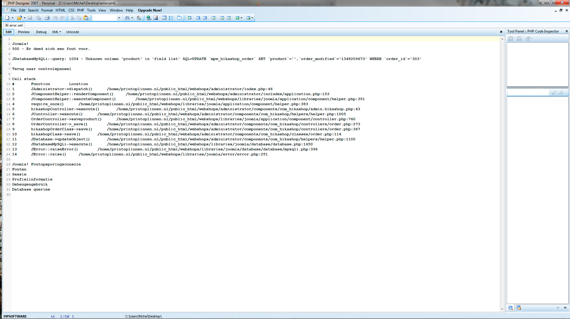

Yes I do. Errormessage attached.

I don't see anything in that file.
Please do a screenshot.

13 years 11 months ago #66587
Here the screenshot

For some reason is seems that you have a custom field with the column name "product" but that this column does not exist in the database.
You will have to create it manually by running the query below via PHPMyAdmin:
ALTER TABLE mpw_hikashop_order ADD `product` TEXT NOT NULL DEFAULT '';
OR delete that custom field and create a new one (which should create the column in the database.
