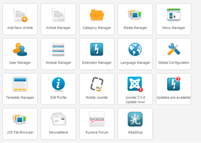

UPDATE
Plugin now available at joomla.org under extension specific for hikashop.
I know there is another plugin that will show all of hikashop links under the quic icons of the control panel, but I needed to create this, so now I'm sharing if someone need it.
Hope it help some of you.
I submitted to joomla.org extensions but still pending so here is the file until it shows on their site.
Quick and simple admin plugin to access HikaShop directly from the control panel. Just a simple and clean access icon that links to the HikaShop Dashboard.
