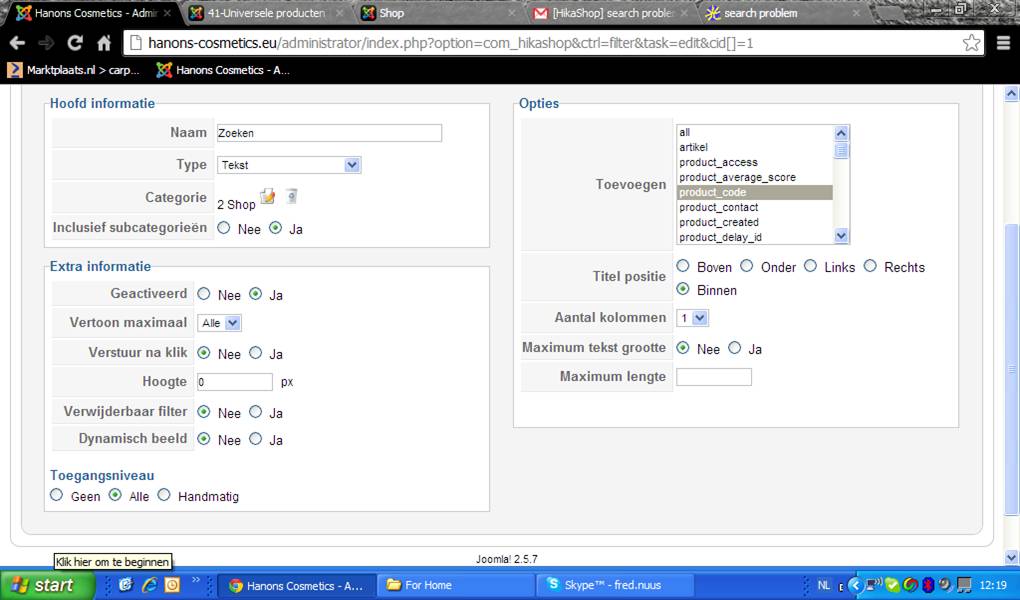

13 years 9 months ago #74180
Could you please post a screenshot of your filter?
You should add product_name as well
Last edit: 13 years 9 months ago by Eliot.
  • Posts: 40
13 years 9 months ago #74192
I send you a screenshot.
And why he create so lot of empty space under de search field in the front-end.
Fred
  • Posts: 86075
  • Thank you received: 14184
13 years 9 months ago #74364
The problem is that in the options of your filter module, you need to enter in the "menu" option the id of a products listing menu item displaying all your products. There is such menu item created by default by HikaShop so you just need to get its id there.
