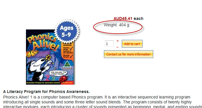

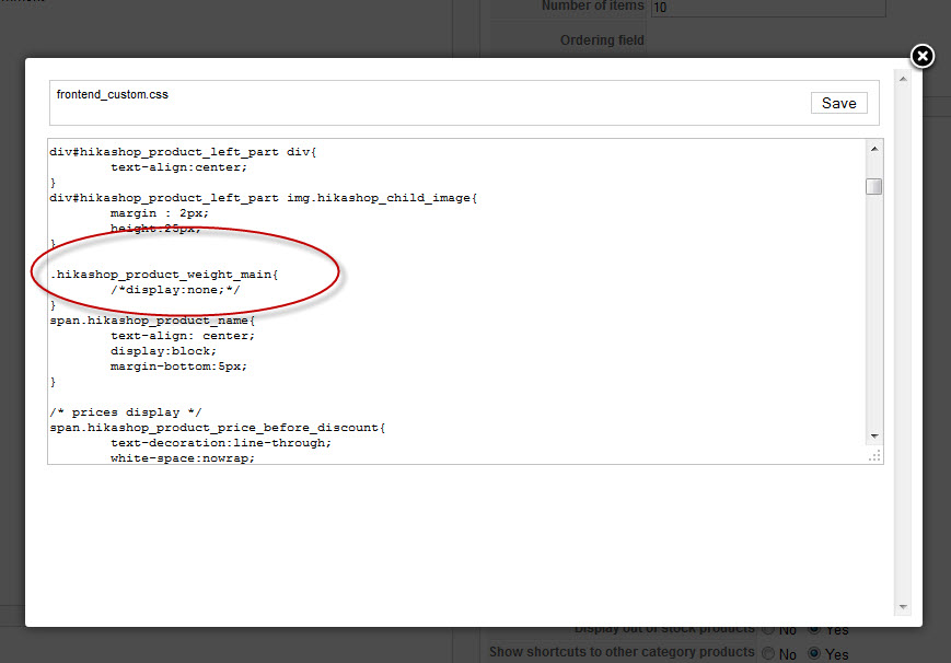

I have previously been told to change the css file for this but still showing for some reason, it seems to be changed back from what was there as had all the language changes I made, but they are fixed again now. Maybe from updates???
I do NOT want the weight to show and I think this is right - see screenshots. THANKS

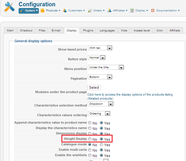

I think that you should :
- Go to "Hikashop->System->Configuration->Display"
- Set the "Weight Display" option to NO
Hope this will help you.

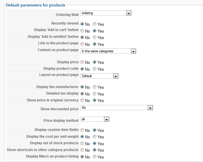

13 years 7 months ago #84866
thanks, but I can't see anything on the display page about weight other than below, which is no. Sorry, am I not seeing where it is?
13 years 7 months ago #84877
This option is in the "General display options" tab don't you have it :) ?

13 years 7 months ago #84895
Do you mean MAIN
here it is
13 years 7 months ago #84913
No I meant the "General display options" part of the "Hikashop->System->Configuration->Display" see attachment :).
Are you using the last version of Hikashop ?

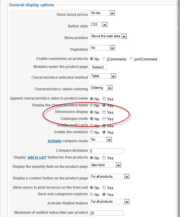

I have no field that says WEIGHT DIMENSIONS - see screenshot
I checked your screenshot and demo site but here, mine is different, not very old version but will have to check. I have paid for enterprise version.

13 years 7 months ago #85908
We had no links on "ACTIVATE compare mode" or "Display 'ADD TO CART' button for free products".
It means that you should have some view overrides and you don't have the latest configuration screen of HikaShop.
