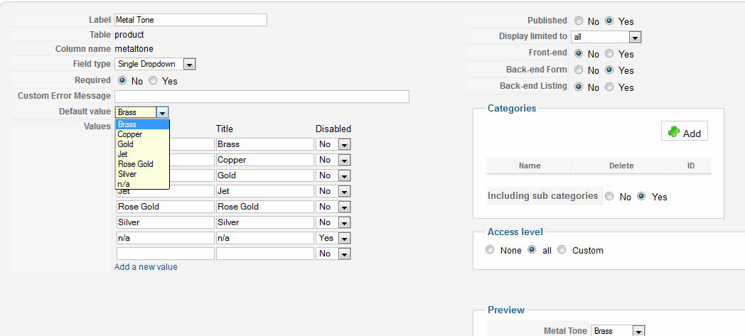

i have a set of filters based on custom fields that work perfectly. Problem is, none of them are required, but when I create a product, that product is automatically associated with every custom field's default value, when I don't want it associated at all, hence "not required". I created a "n/a" value and set it to disabled hoping that would work, but it shows up on the front end as an option in the filter. I need to make it so products that do not require the custom field do not need to be associated with it, or make a designated "N/A" value not show up in the filter. I can't define it by category because the custom fields vary per product within a given category. help would be appreciated.

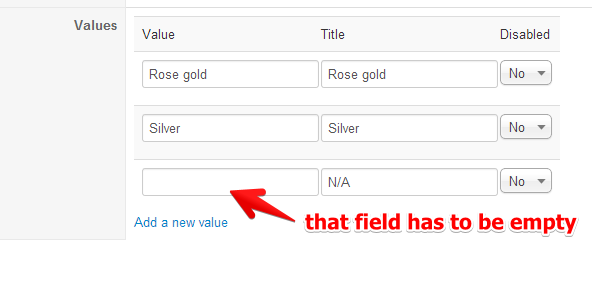

You need to change the n/a value of your custom field. It shouldn't be configured like you did but like that:

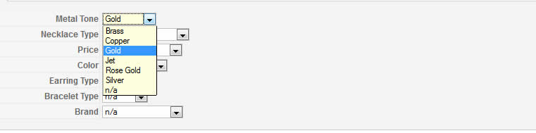

okay, i did what you said and it is still showing up on the front page in the filters. I don't want an n/a option on the front end.

If the filter's dynamic display option is turned on and that you're on a products listing where no products have that n/a value, it won't display that option.
Otherwise, it will.
To really remove the value from the filter all the time, you would have to change the line:
$field->field_value[$key]=array($temp[0],$temp[1]);
to:
if(!empty($temp[0])) $field->field_value[$key]=array($temp[0],$temp[1]);
in the file administrator/components/com_hikashop/class/filter.php
