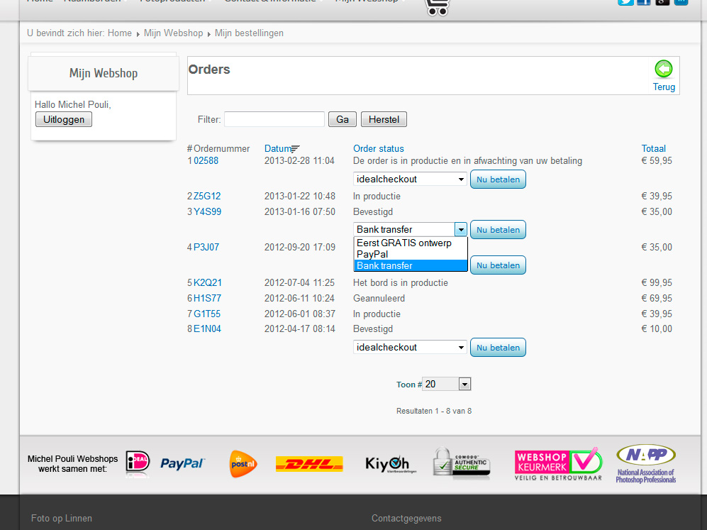

I use the iDEAL payment plug-in and it worked fine till now. When the client want's to pay after approval of the order, the payment options aren't showing the iDEAL option anymore. It only shows up when the paymentmethod is set to iDEAL in the order in the backend. In the screenshot the upper order has the paymentmethod set to iDEAL in te backend, the one without the iDEAL option has the paymentmethod set to banktransfer.
See screenshot:

It's probably because the ideal payment plugin is not published or that it is restricted to some user groups or zones.

Yes you are right, it's caused by the Zone that's set to "Netherlands", because iDEAL payment is only available in the Netherlands and I have foreign customers too. I don't want them to have the option to pay with iDEAL. So, how do I have to solve this?
Michel.

The current ideal version 2 payment does not allow payment from foreign countries, but the ideal version 3 implementation will accept that.
This version 3 will be active around the summenrtime and version 3 will replace ideal version 2 from august 2013.
So I suggest removing the zone restriction and make sure your idealpayment implemewntation cn handle ideal version 3.
I already did the same on several webshop i created and used a ideal plugin which is already capable of handling ideal version 3 payments......

Normally however, the ideal payment method should appear in the dropdown if the order has been made with an address in the zone to which you restricted it.
If that's not the case, then maybe there is a problem with the way the payment plugin checks on the zone restriction.
However, that is handled by the payment plugin itself, not HikaShop, so we have no control over that.
