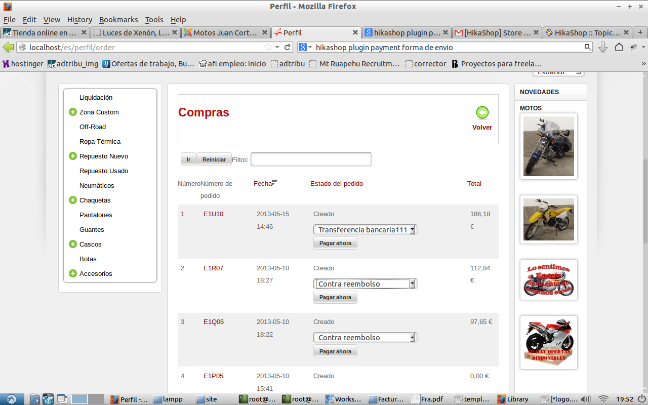

Hikashop Bank Transfer Payment Plugin named Transferencia bancaria111,
something weird happens,
it stop showing in the orders(compras) page. in the picture i ve send, the number 1.
Bank transfers payment plugin can t manage Zones restrictions?

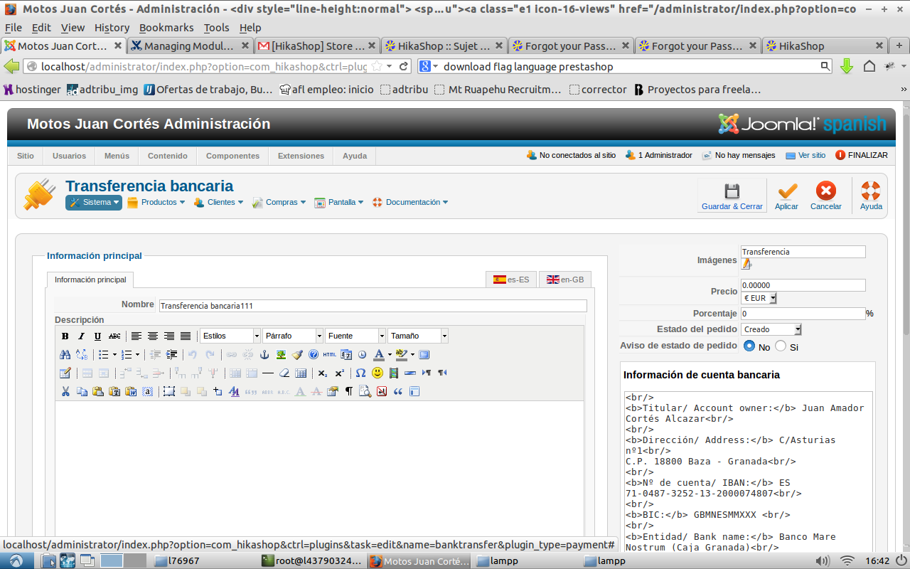

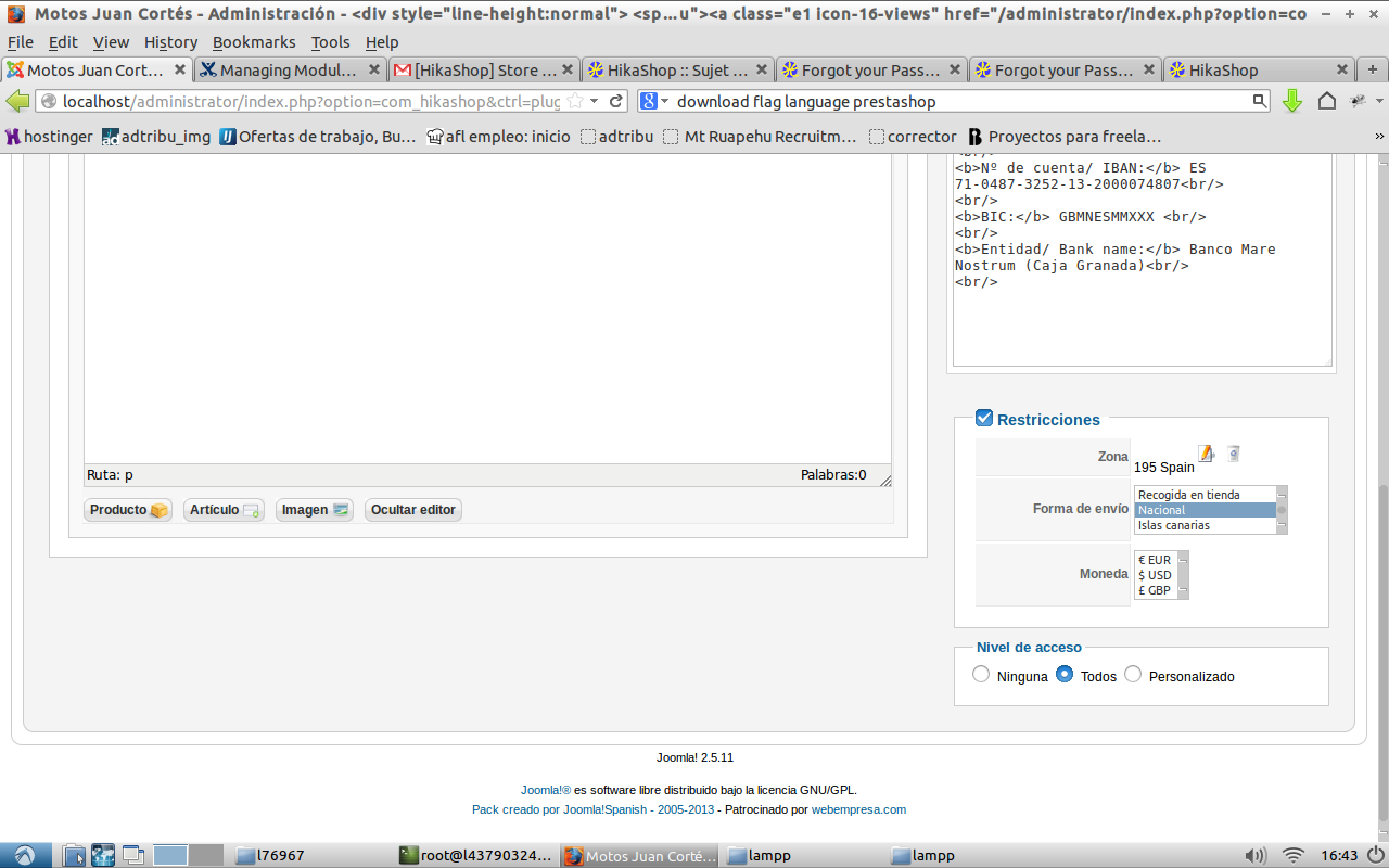

13 years 3 months ago #104309
This all the payment methods manage the zone restrictions, can you give us a screenshot of your bank transfer method configuration ?

13 years 3 months ago #104373
Then it probably means that you user address is not in Spain.
