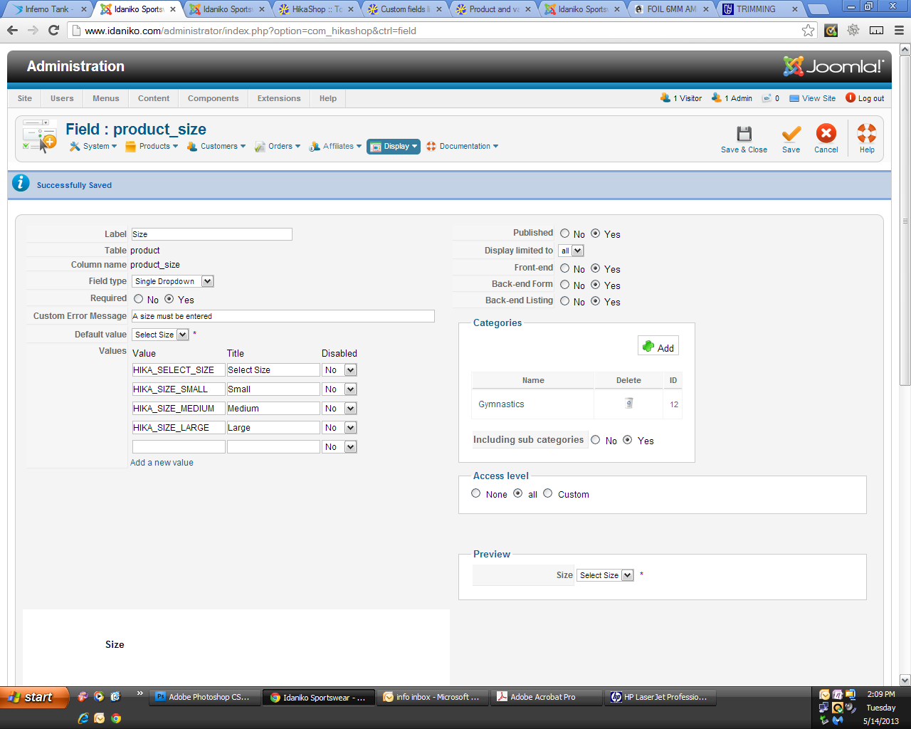

Then maybe you actually don't want to use characteristics but options ( www.hikashop.com/en/support/documentatio...ct-form.html#options ) or custom fields of the table "item" ( www.hikashop.com/en/support/documentatio...p-field-listing.html ). Each one has a pros and cons. One of the pros of options and custom fields is that they are light weight as they don't create variants for the product (which is a cons if you need to change the price/image, etc per variant).

The "product" custom field is stored in the product table and is seen as a fixed value in the product page.
The "item" custom field is stored in the user cart. The customer will have to select a value in the product page.
To resume
product : the drop down is displayed in the backend. Value displayed in the front-end product page.
item : the drop down is displayed in the front-end. Value displayed in the backend order page.

Well, as explain in my previous post, product custom field are not the right solution.
So you have to delete the product custom field and create an item custom field.
