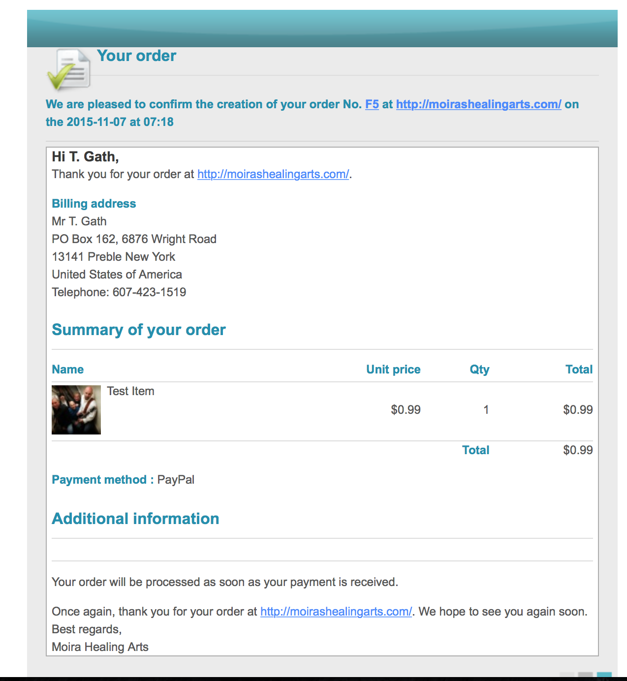

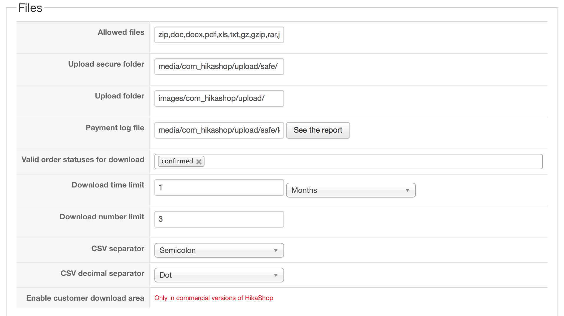

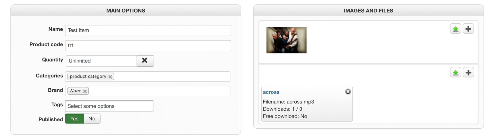

Sure can. Thanks!
HikaShop Starter 2.6.0
Joomla 3.4.5
URL: moirashealingarts.com
Attachment1: File section of the Product Configuration
The order is NOT automatically confirmed when payment is received.
Attachment 2: The order status notification email
I noticed that there are no conferment payments in the payment log file so I have added an additional Screen Shot: File settings from Order Config page.

So you didn't give a screenshot of the order status notification email (which is sent after the order is confirmed) but a screenshot of the order creation notification email (which is sent at the end of the checkout).
The issue is that HikaShop doesn't receive payment notifications from the payment gateway and thus it cannot allow the customers to download the files.

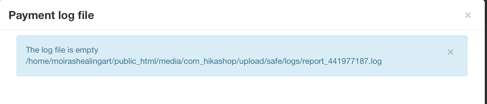

Here is the information from those steps:
Sever Log (I think):
173.0.81.1 - - [09/Nov/2015:07:12:51 -0500] "POST /index.php?option=com_hikashop&ctrl=checkout&task=notify&notif_payment=paypal&tmpl=component&lang=en&Itemid=178 HTTP/1.0" 200 - "-" "PayPal IPN ( https://www.paypal.com/ipn )"
70.195.134.130 - - [09/Nov/2015:07:13:09 -0500] "POST /index.php?option=com%5fhikashop&ctrl=checkout&task=after%5fend&order_id=6&Itemid=178 HTTP/1.1" 500 2074 "-"
The Payment Log file is in the screenshot attached below.
Thank you for your continued persistence on this issue.

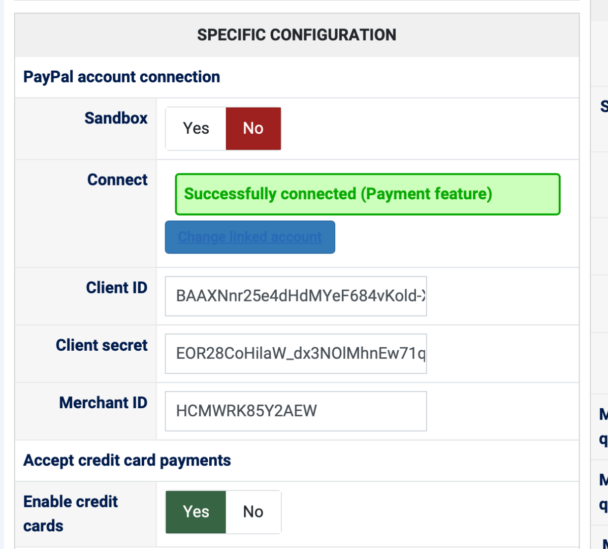

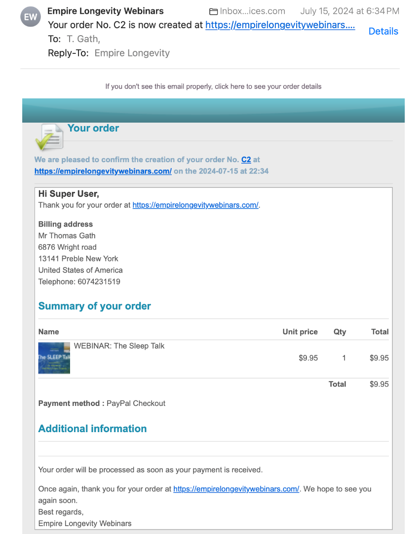

Thank you for your reply! So I am using Hikashop Starter 5.1.0 with the PayPal Checkout plugin that comes with it. PayPal is configured successfully (see screenshot) I have also attached a screenshot of the email that I received after purchase.
To step back, What I am trying to do is have a customer pay and then have videos available for them to view. If a 'view link' isn't possible then a download button would be my second choice. I will appreciate any suggestions that you have to help me accomplish this.

This is the email sent when the order is created. HikaShop sends a second email once the order is confirmed, after the payment. And the download link should be in this second email.
Did you receive the second email sent to the customer for that order ?
What is the order status of this order ?
Can you provide a screenshot of the order's history ?
Can you check the emails for that order in the Customers>Email history menu ? It's possible the email was sent but not delivered.
